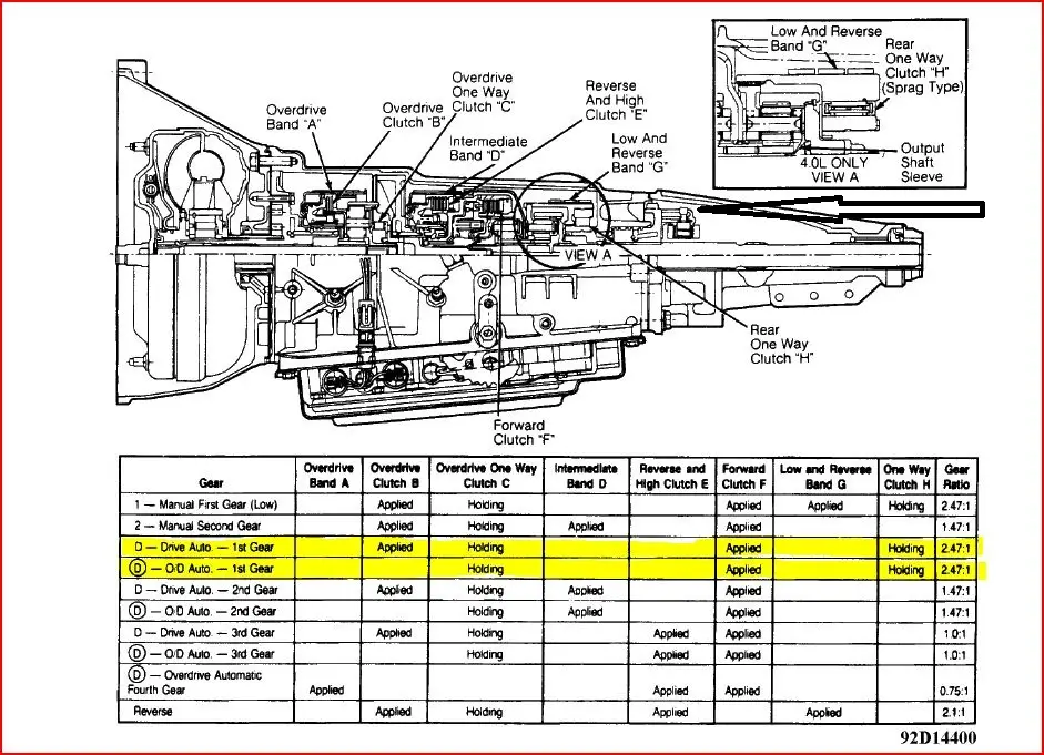

Here is the location of the governor: (this image shows the 2wd tail housing)
As you can see in this image the 4x4 tail housing has a big opening where you can simply reach in there with the transfer off and give it a brake cleaner bath and a shot of clean ATF for pre-lube. You can also "excersize" it up and down gently with a skinny flat head screwdriver to check that it moves freely. (careful not to scratch the journal)
