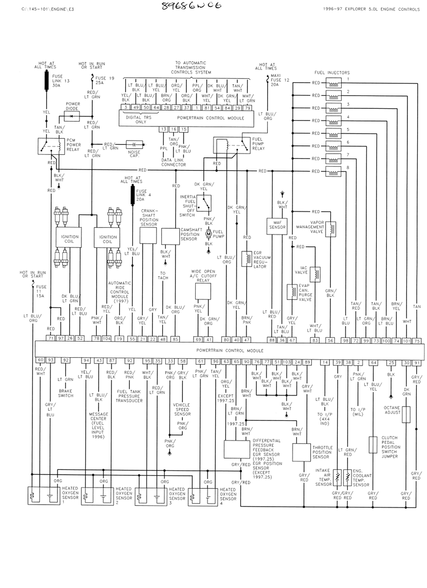

that black plug is the 42 pin connector I am speaking of
every wire to control your drivetrain (engine trans) all go through there EXCEPT the fuel tank wiring and alternator charging harness
You need to map out that 42 pin connector, get yourself a 97 explorer wiring book
IN the explorer that plug is called connector C115 I believe, in a Ranger its C112..... they change the name but it is always 42 pins, they all plug together and MOST of the wires/circuits stay in the same holes...but not always and there are MID YEAR changes, so this is why nobody can make a simple chart of how to control your 5.0 drivetrain. You have to map out the one you have!! and then decide what wires need power, ground, signals, etc.......

Ok thanks so much. So where do I find this book of the wiring ?? 👍😃
That forsale ?
Found that one on eBay for 30 bucks.... That's going to be the closest thing there's no step by step on this but it would give you alot of information about where each wire goes.

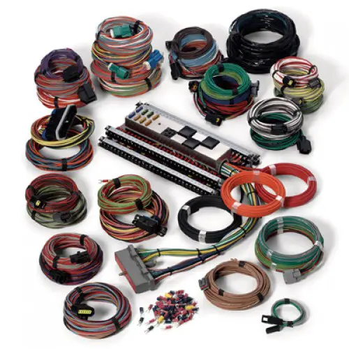

Looking out for what u need... On a side note I'm seeing some pretty cool stuff...led for check engine...ect I can see why u want to do this but curious still why not buy a standalone harness for 5.0 obd2 ford?
Just wanted to make it happen on my own
This way your saving alot of headache finding each pin....dont gotta find the plugs or anything it's all ready to go and as u can see it's still pretty complex. Also not that 850 dollars one a cheaper one...or pull a harness from another explorer.
$850 for something you already have in the donor truck is silly IMO
Map out the wires in the factory harness
