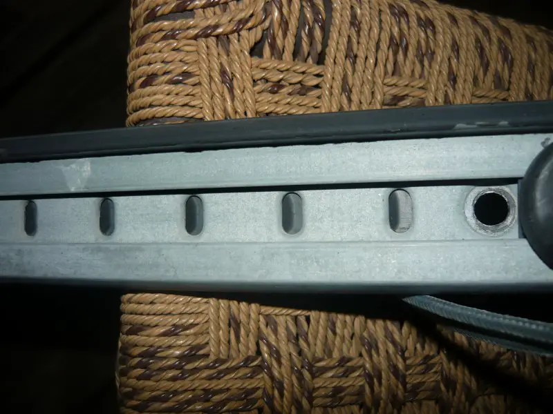

How hard was it to undo the tracks from your truck. I never took mine off but have recently developed a roof leak from somewhere. Like pretty bad. I dunno if its the sunroof, or since this is really the first rains since I put on the x bars, maybe I wrenched it too tight and something came loose under there. I'd like to take them off and re caulk the screw holes to see if it fixes it, and if not some piece of mind.
I also doubt that is where the leak originates, Unless it has been removed before.
If you do need to remove it to check, What I found easy was a Large phillips screwdriver bit, driven by a 1/4" drive ratchet and extension with 1/4" socket. some racks are attached with Torx screws, in this case substitute a torx bit for phillips screwdriver bit.
Be sure to push down while backing the screw out.
