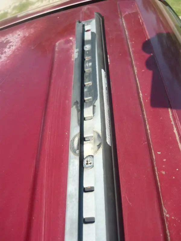

Once the 1st gen rails are attached to your Mountaineer, find joy in the fact the crossbars are now a lil over 1" too long. oh yay. just what i was hoping for. Otherwise this would be a wrap.
I have 3 of em trimmed, and re fit . 2 more to go.

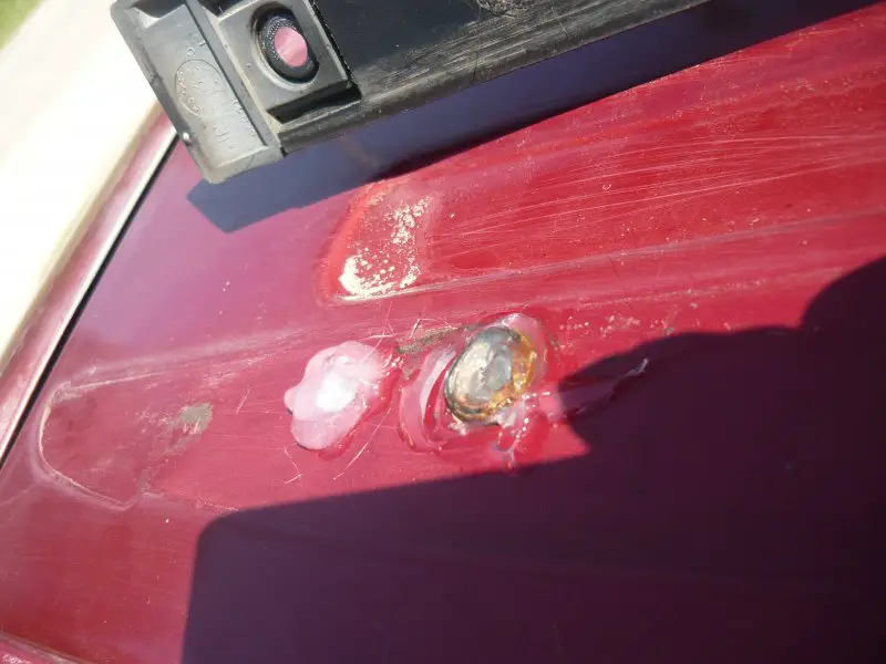

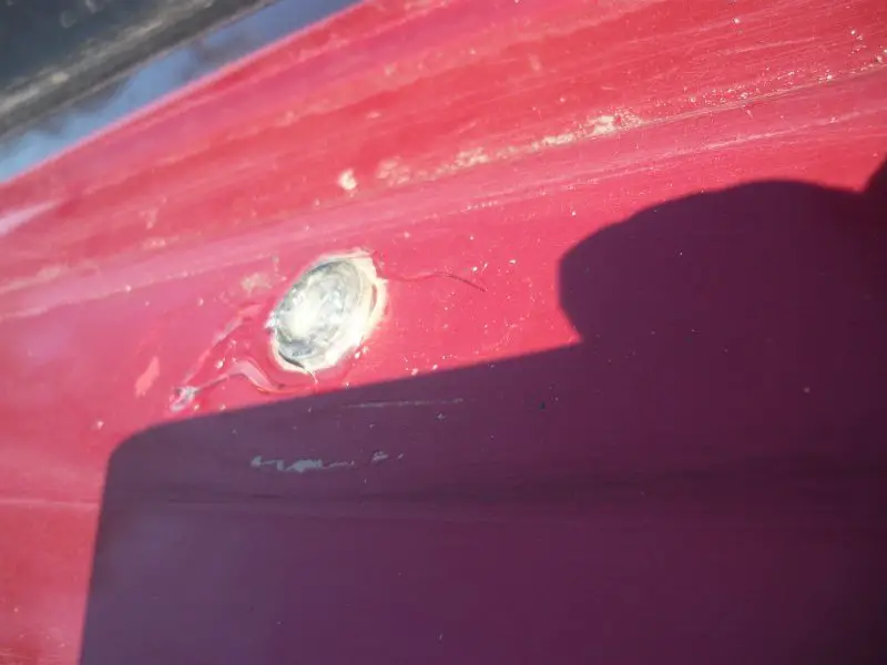

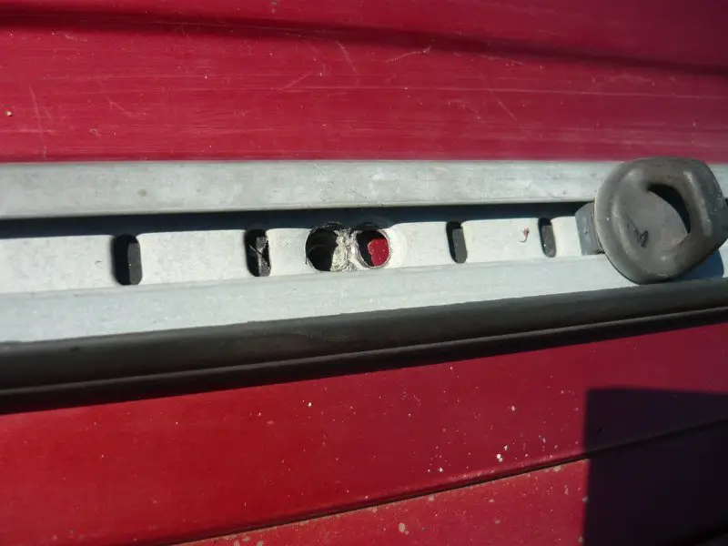

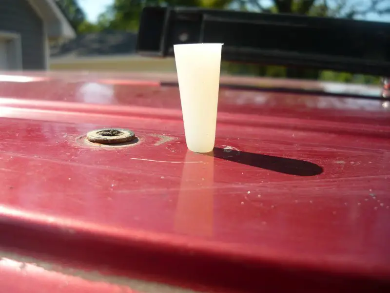

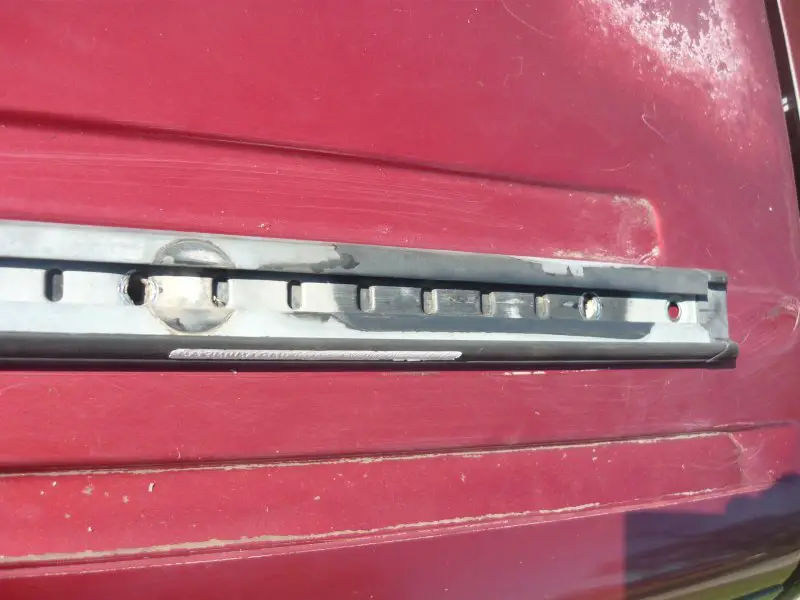

Ok, first, the bolt hole pattern does not match, as Don said. Fortunately 2 you have to drill are located on previously machined ovals.Hopefully these pics will give you what you need.

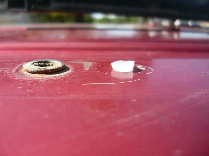

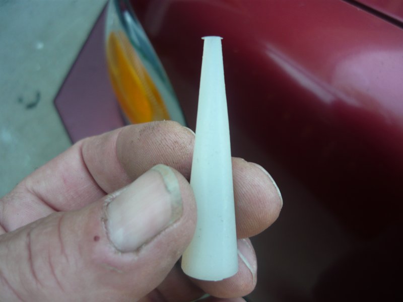

You have some extra holes to fill. I used some silicone plugs, wedged in real tight then trimmed with a razor. Leave a little exposed so the rail will push it tight.

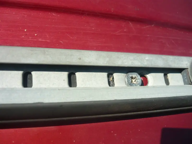

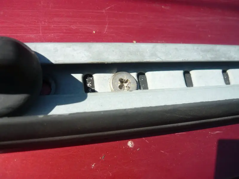

Now you can screw the rails down. I used my stock mountaineer bolts because the heads were much larger. They just clear the rail gap.

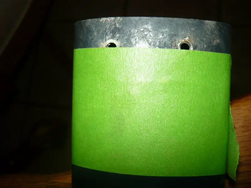

First, the 97 mountaineer bars.

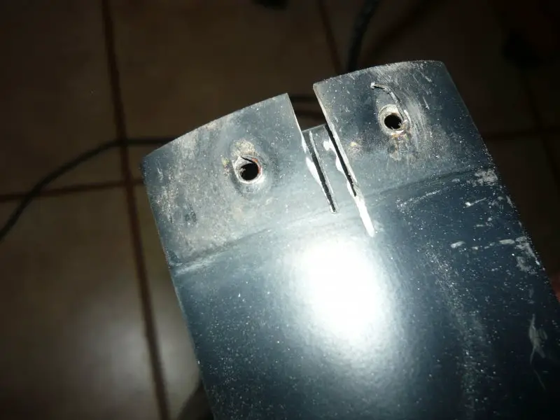

One end is slotted, or keyed so you cannot get them backward. However, you must lengthen the slot so that is step 1
I used my dremmel tool for this

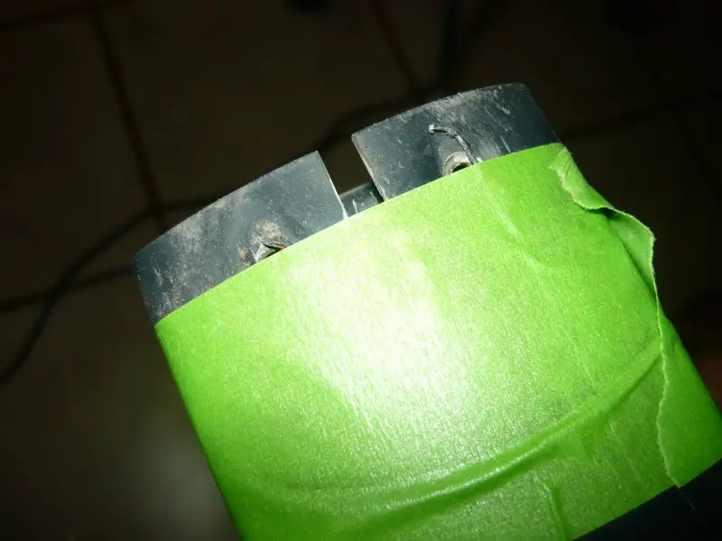

You need to cut off about 1/2" from each end, so tape em off square with the bottom of the existing holes. (yeah, some has to come off each end or you'll be humping to the side)
Once you have em cut down, and your slot is trimmed to allow the tube to fully seat, take to the truck for a test fit. If all fits well, drill some new holes

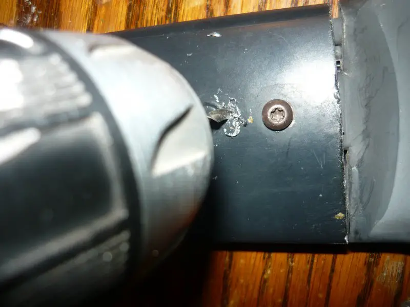

After removing the ends, slide out the rubber top pad. Mark your cut lines as above ( 1/2" off each end) , make your cut and test fit the ends, taking the whole thing to the truck for a test fit. Once it fits. slide both ends back off, slide the rubber pad back in and trim it to length.
Then drill a new hole thru the metal, and a tapper thru the existing metal hole, into the plastic.

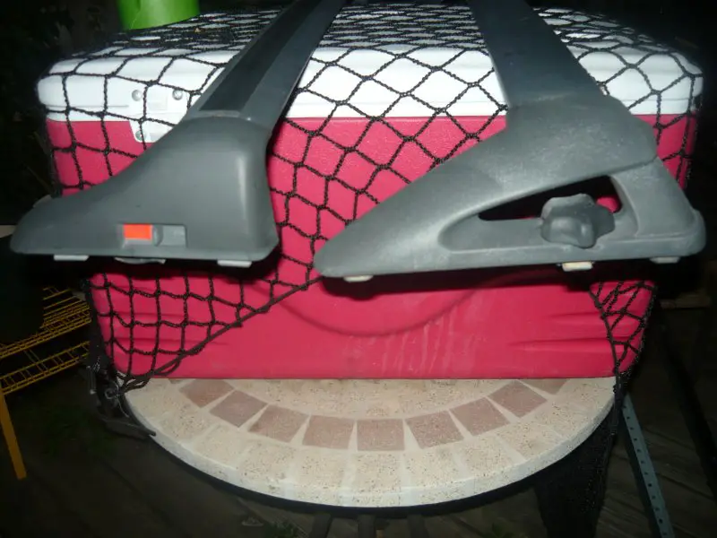

98 explorer cross bar on left. 97 Mountaineer cross bar on right.

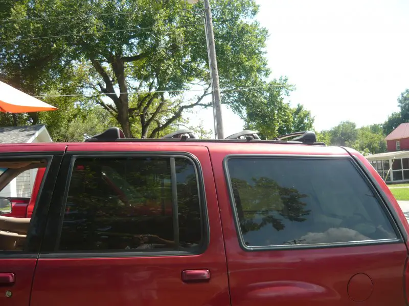

I give you, a mounty with 1st gen roof rails and 2nd gen cross bars.
Who would have thought the Mounty Rails would be 1" narrower Than an explorer. That means a whole different manufacturing process for the roof.
You learn something every day.
