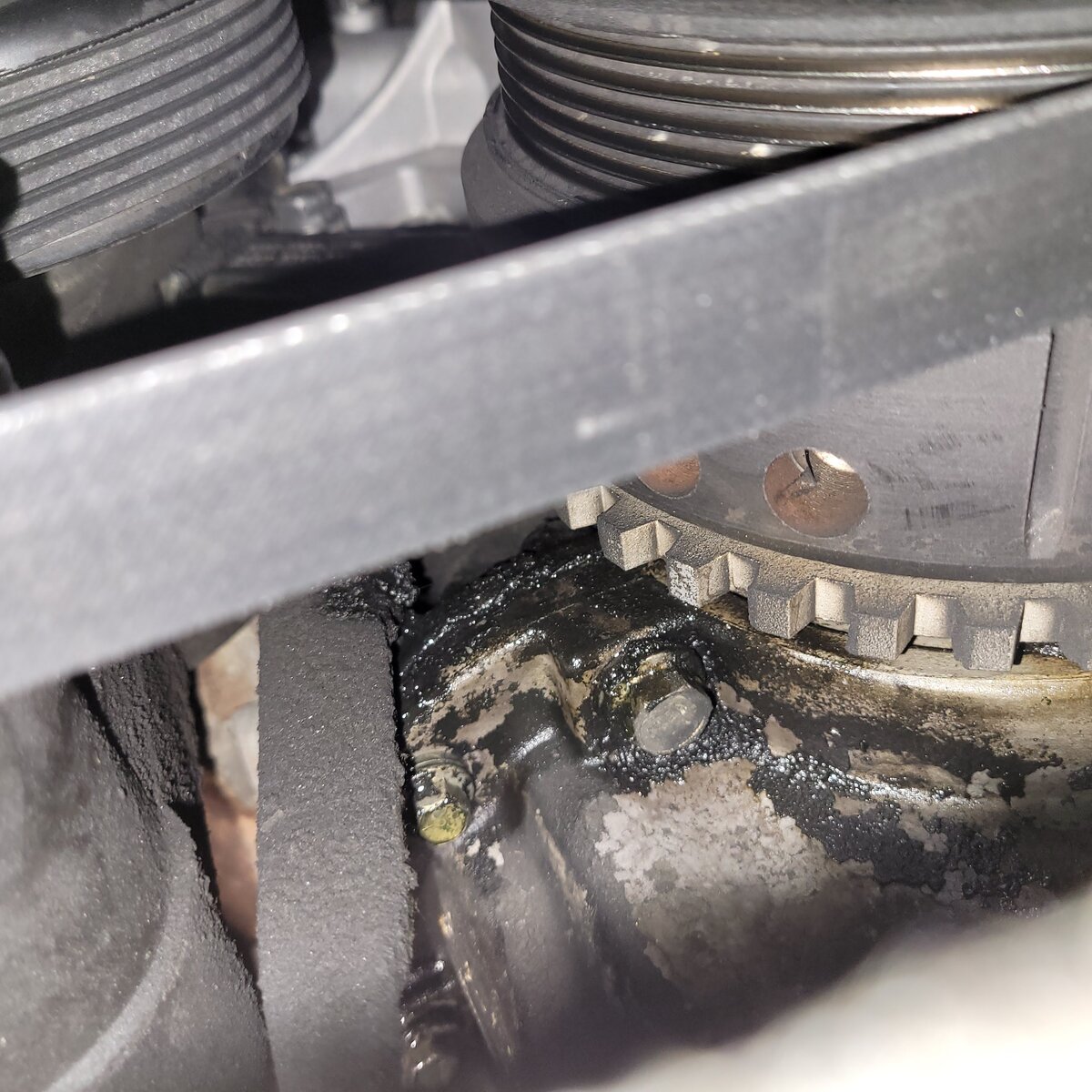

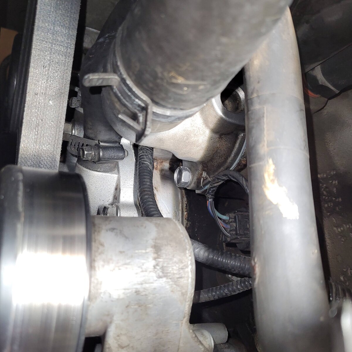

1 month ago, water was leaking out of engine at front. Replaced water pump. Upon inspection, the stock water pump was probably OK, but wasn't going to reuse a 150k miles pump. Noticed thermostat housing leaking. Fixed as well. All good for a month. Today, water leaking from front, same exact spot. Inpected all that I could see of my previous work. All good from the top side. Inspected all the hoses. All good. Almost impossible to check things from underside. Super cramped. But, I've a endescope which I attached to a wire. With it, I was able to see the lower water pump bolts. The ones that would have tell-tale signs of water dripping off of them if the lower gasket on the water pump had failed. Dry as a bone. No indications water was leaking there at all. I know on the 302 there's the water pump, then there's the housing that doubles as the timing chain cover that the pump attaches to. Water flows through this housing into the block. Any chance that this housing is cracked or the gaskets are weeping? I won't be able to see anything until I take everything apart again.

timing cover leaks are very common on older 5.0 yes
The water does indeed flow through the timing cover and into andf out of the water pump
The timing cover gasket is known to develop leaks and needs to be replaced
There are a few tips and tricks to know for doing this repair in the truck
I can usually do it in a half day or full day depending if any of the bolts break

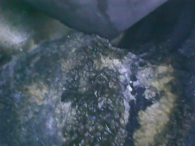

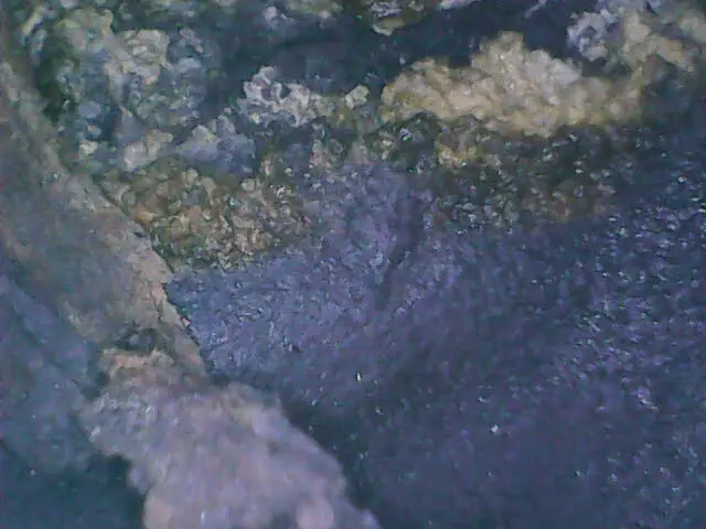

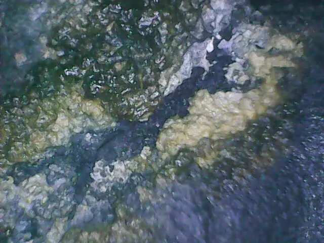

Thank you. The leak is intermitant too. Yesterday, 1 quart leaked. Today, a cup. Using the same endoscope, this is the area where the timing cover meets the block, behind the alterntor, where the passnger side water passage goes throught the timing cover meets the block. Looks like a likey culprit to the water leak.

Yes timing cover is unique to explorer 96-01 can get replacement around $100 or less of yours gets *****ed up
4 of the water pump bolts go into the water jacket
Those 4 same bolts are the ones that usually snap when doing timing cover so you maybe in good shape
Bolts are 5/16” various lengths and heads
The oil filter adapter is unique to explorer also but it attaches to the block not the timing cover. The 96-97.5 trucks have a oil cooler built into the oil filter mount in 98-01 it went away (failure point)
Timing cover is not a terrible
Job but there are some things to know like 4-6 bolts go upward from the oil pan and in order to get the timing cover off it will have to clear the locating dowels before it will pull up and out of the oil pan. Need a crank damper puller, oil change, gaskets, coolant
