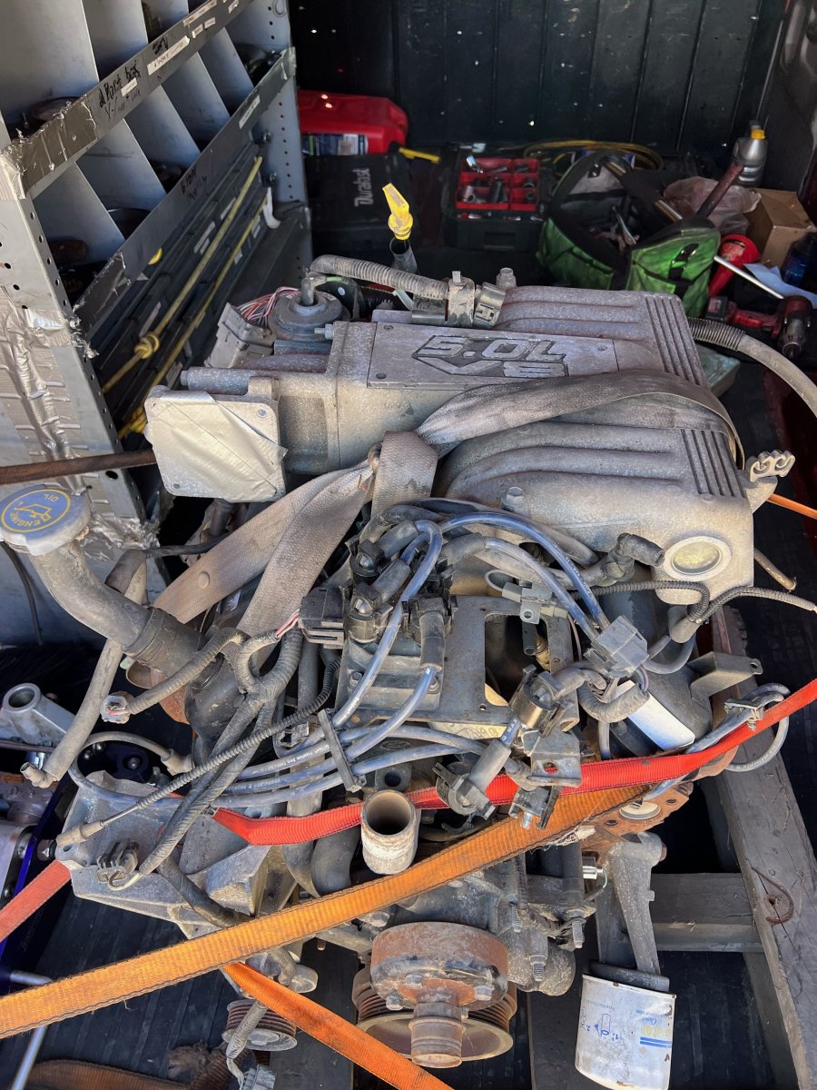

5.0 waaaaaaaaaaay easier to deal with then sohc
Starter access is better and the starter actually comes out of the space lol
What i do is drop the trans crossmember out of the way, then remove the t case, let the trans hang, now you can access all the exhaust starter and bellhousing bolts from the tailhousing area with a long extension
Remove starter and converter access plate, rotate engine with 15/16 socket to get all 4 of the converter bolts
Not exactly in that order
Removing the front seats and console, get access to floor plate,
This helps some people
Unplug 3’of the 02 sensors and get easy access to the top t case
Bolts. Not necessary if you get the truck up high enough and do like I said before,
Letting the trans hang
