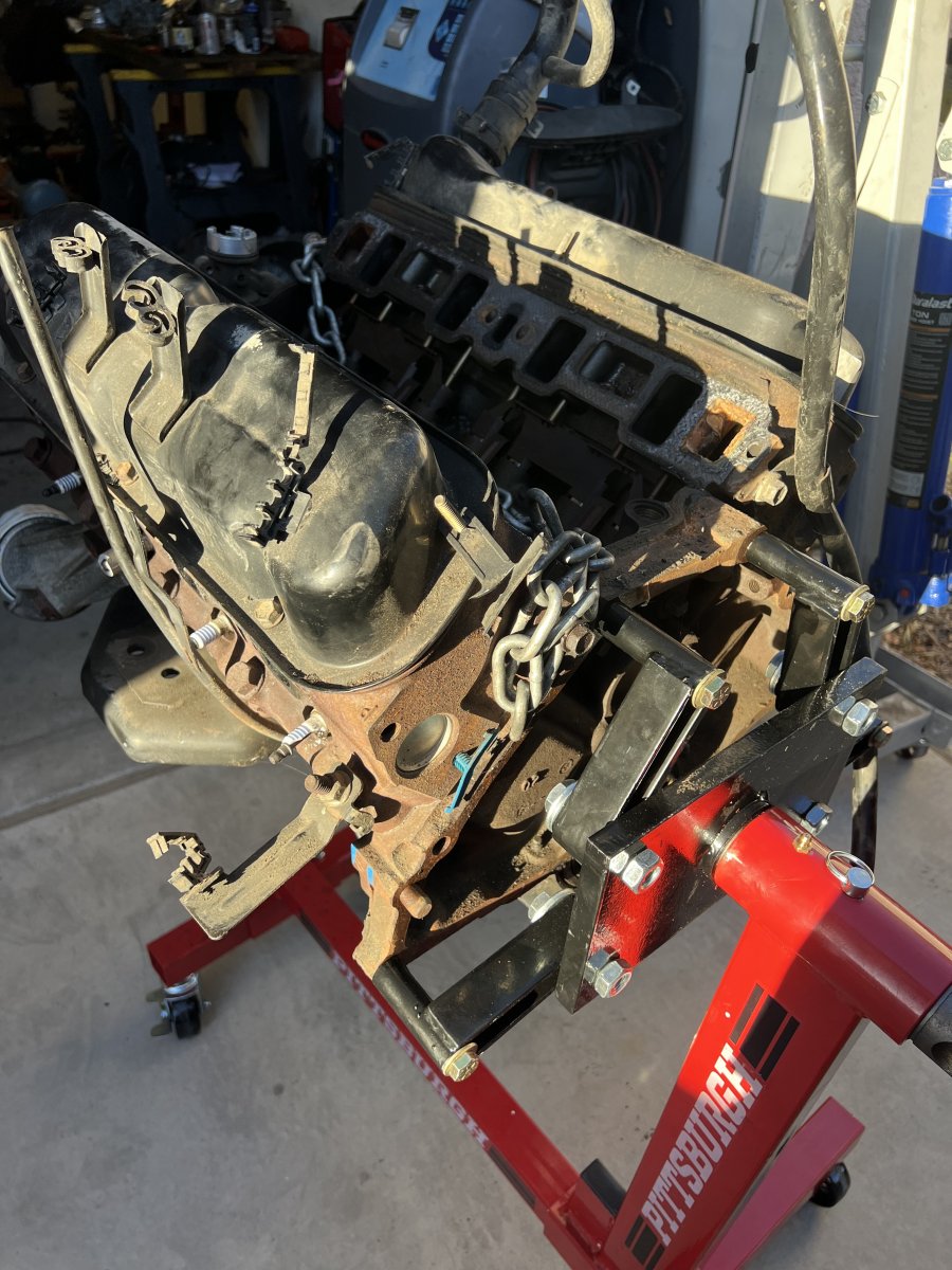

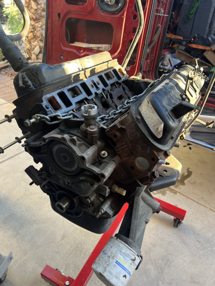

I still have the engine in the back of my van. Need to unload it and get the valve covers, timing cover and oil pan off. I will be looking at the bearings.

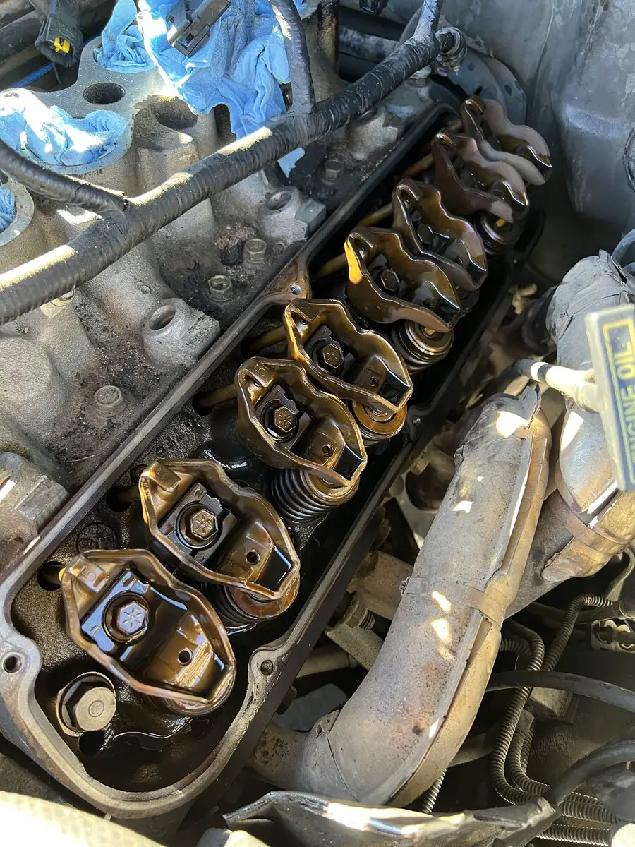

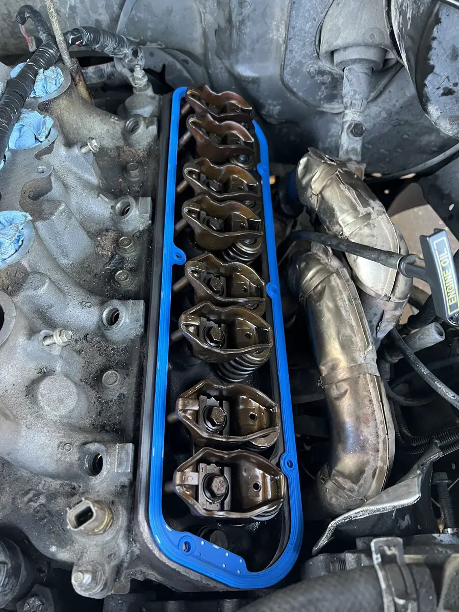

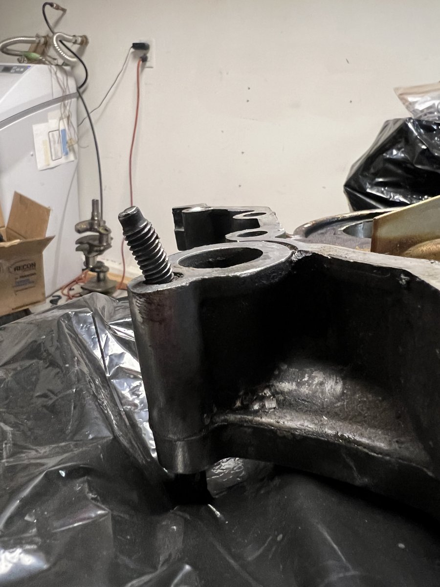

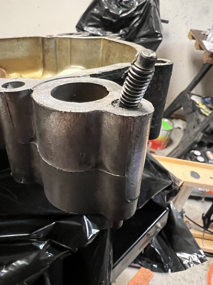

Started cleaning things up tonight. Pulled the plugs. Started cleaning off gasket surfaces. Pulled the timing cover. The water pump bolt that broke was only corroded into the timing cover. I know you’re all familiar with that. The thread in the block moved freely, so i just spun the cover off with the bolt stuck.
