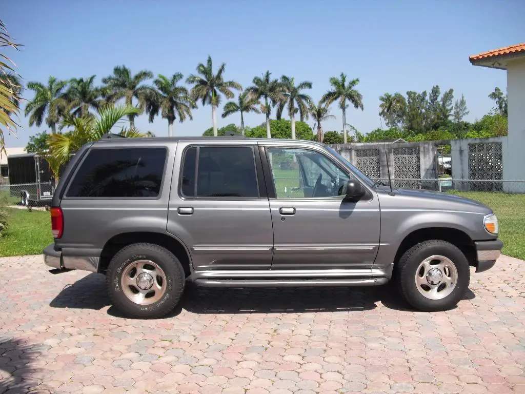

Here's a pic.

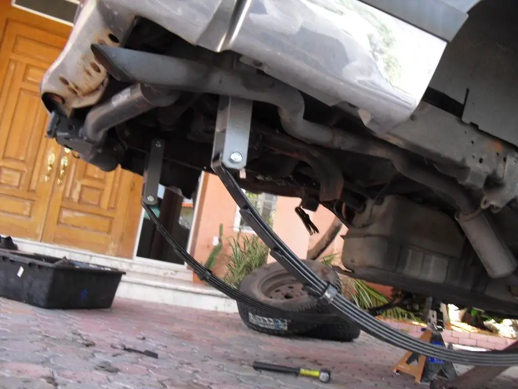

Thanks for the replys. Most of the build spec's only mention soa for the rear or hybrid leafs. Has anyone done a soa using 4" leafs?

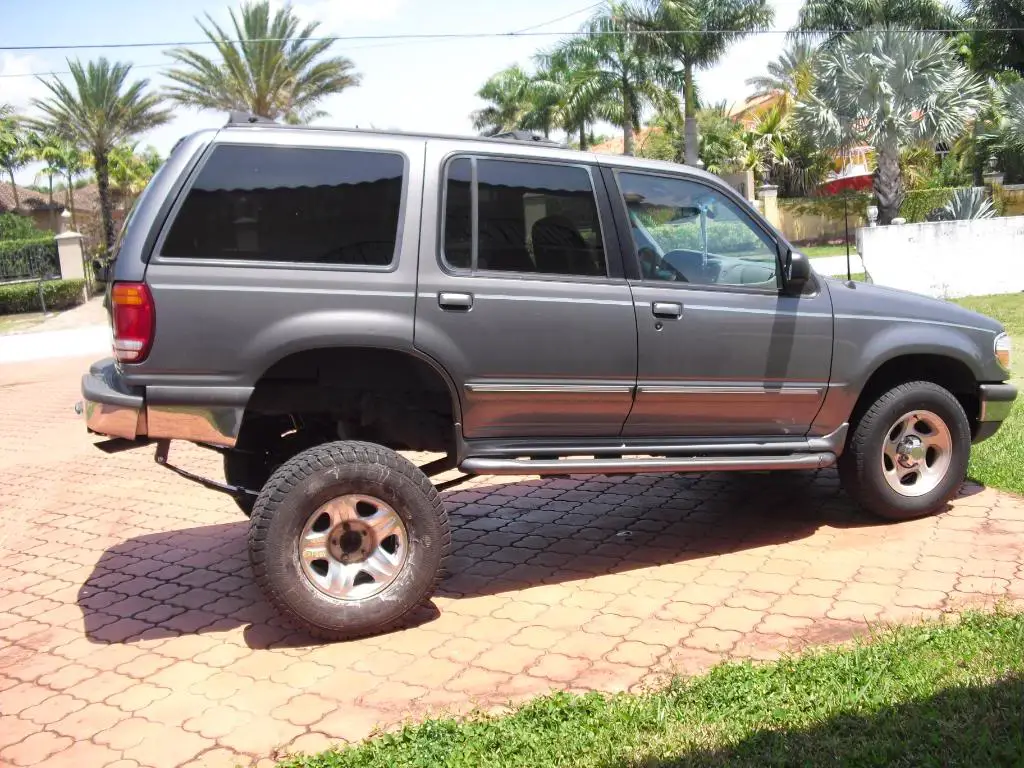

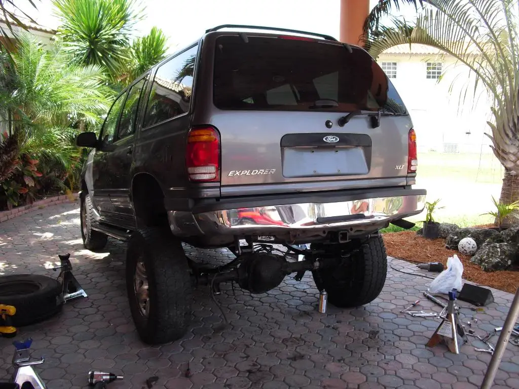

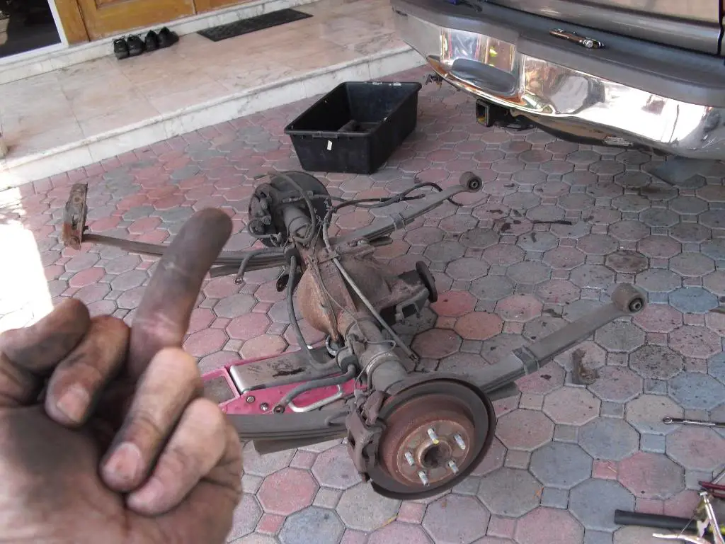

Today I installed the 4" leafs SOA, 1.5" shackles, and the 9.75 w 4:10s and trac-lok. It took me about 3 hrs. I will tackle the front soon.

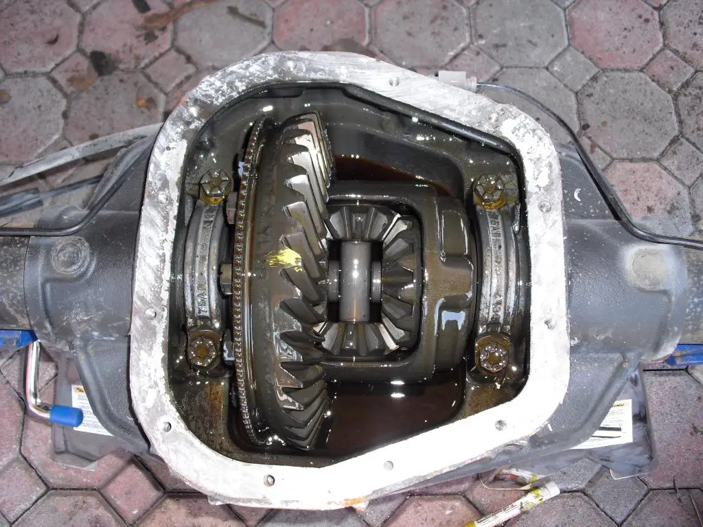

Also.. Who told you the 9.75 had a trac loc? Or are you going to install some kind of LS later?
I would run wheel adapters. The rear axle will be narrower then the 44. What gears are you going with? 410's and the 4.0 will not spin 40" tires. Not sure how high the ratio goes for the 9.75.
Being that this rear is out of a 2003 Ford SVT Lightning it came with traction lock from what I had read.
