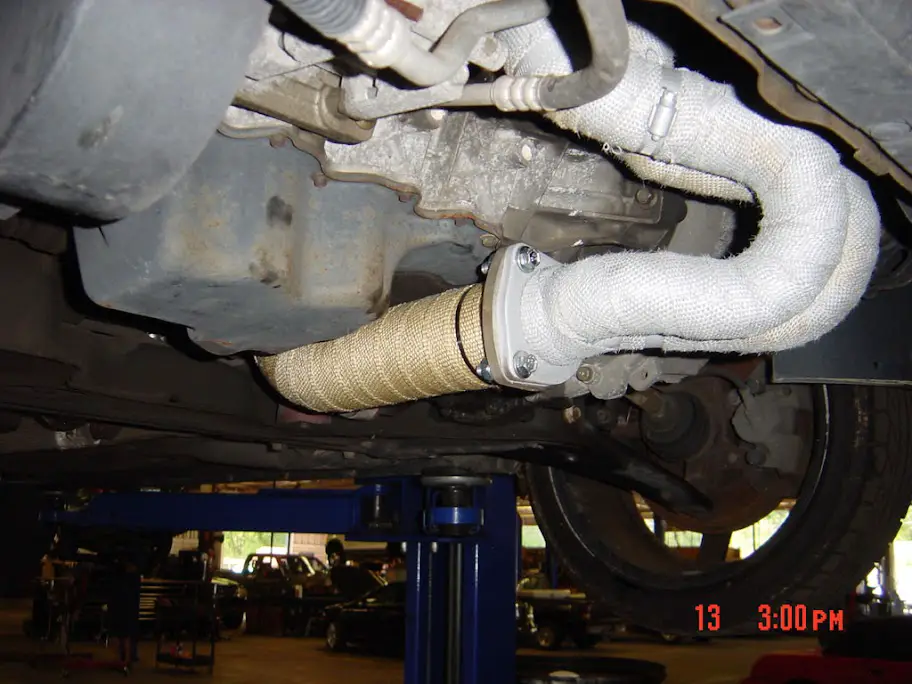

I know on my SVTf... I have the Cosworth SVT header on the car... and from there it directly connect to a 3" off-road pipe (in place of the cat).. which connects to a 3" flex pipe to prevent any kind of breakage on engine movement... which then connects to my 304SS 3" exhaust that runs all the way to out the back.
Pix (before some further tweaking):

The pix you quoted was my full 304SS 3" back setup on my SVTf (which I should have home FINALLY next month, lol)...

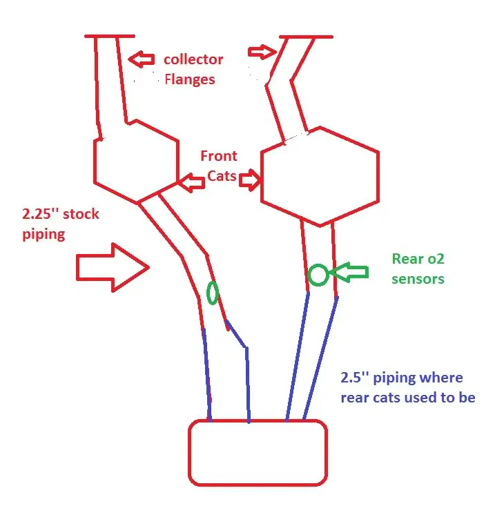

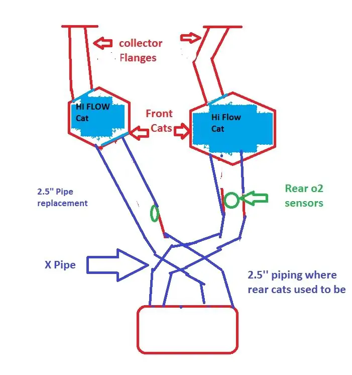

This first diagram shows my current setup of the front portion of the exhaust. Note I didn't label the front o2 sensor location as I cant quite remember at the moment if the front o2 sensors mounted on or in front of the catalytic converters. but this will give you an idea of what I'm trying to show. The 2nd shows my desired idea of modified exhaust.

As for the X pipe though... What is the point of an X pipe before a dual in dual out muffler? The dual in dual out muffler has a built in H pipe or X pipe configuration and equalizes the exhaust already... So in essence, you would be running a dual XX or XH set-up...? Just wondering. Nice paint tho! I need to map my planned set-up sometime like that.
Also... What is the pipe size coming off of the exhaust manifold into the front cats? 2.25"? If so... maybe, while under there, have them upgrade that piping to some fresh new 2.5" piping as well as I'm sure it would only be a couple $s more?
I was considering that idea from the collector flanges. I just don't know the size of the piping as of now off the collector flanges. I guess I could live without an X Pip if all the exhaust in front of my muffler is expanded to 2.5'' with the high flow cats. The Challenge, is finding the right high flow converters. The 2nd part is a shop that'll actually touch my exhaust since I removed the rear convertors. Most around here won't touch because it's technically not legal. I may have to find some speed shops around here that may help.

Also, the only reason I say you don't need the X pipe, IMO, is because having a dual in dual out muffler performs the same function already, so, having both would be a waste :D

I feel ya on the X-Pipe. I will gain more sound volume and performance with upsizing the pipe and placing hi flow's in there. So that'll save a little bit of money right there. On the muffler shop. They did tell me when I requested an x pipe initially that they had to re-install the rear cats if they were going to work on my truck because it originally had 4. Which was a load of crap. I'm going to take Eric's advice and look at some Performance shops that specialize in that area. I already found one right now and will be giving them a call next week. Thanks for your helpful advice as well :thumbsup:
