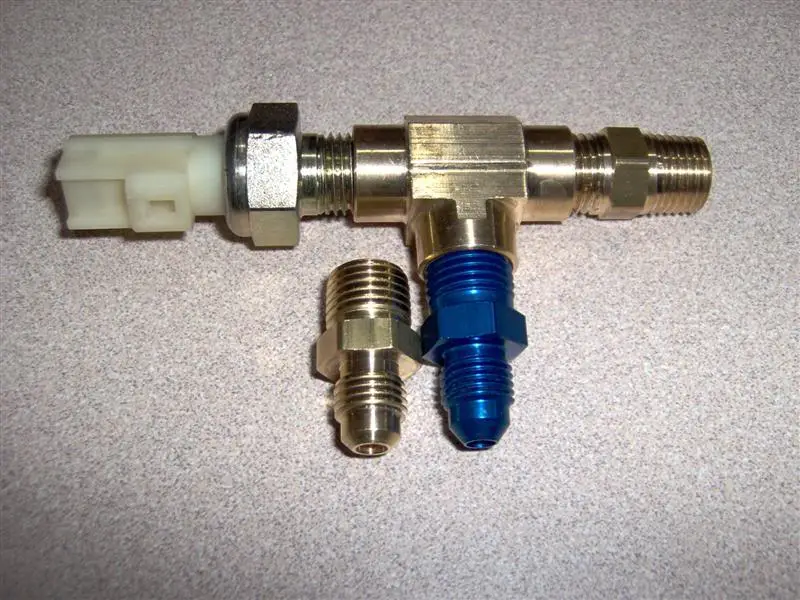

Did you find where the oil line was? There is a pipe thread T at the oil sending unit and an AN adapter on it for the oil line I believe. You should be able to get to it if you remove the drivers side inner fender.

Yeah.. I had found that oil line and man... What a tight fit lol... Can hardly get a hand to it lol... Been busy (just had my son born) but hopefully will get that line removed soon!
