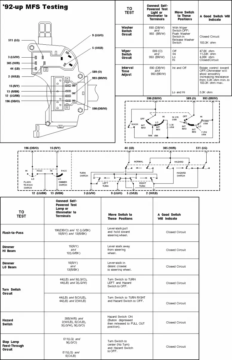

You can test the MFS with a multimeter or disassemble and clean the contacts (I mean the internal contacts more so than the external that plug into the wiring harness plug, except another possibility is the wiring harness plug itself may have wires pulling out the back of it), from oxidation and dried up grease, or buy a new one around $30 aftermarket IF MFS itself is the problem among the multiple possibilities.

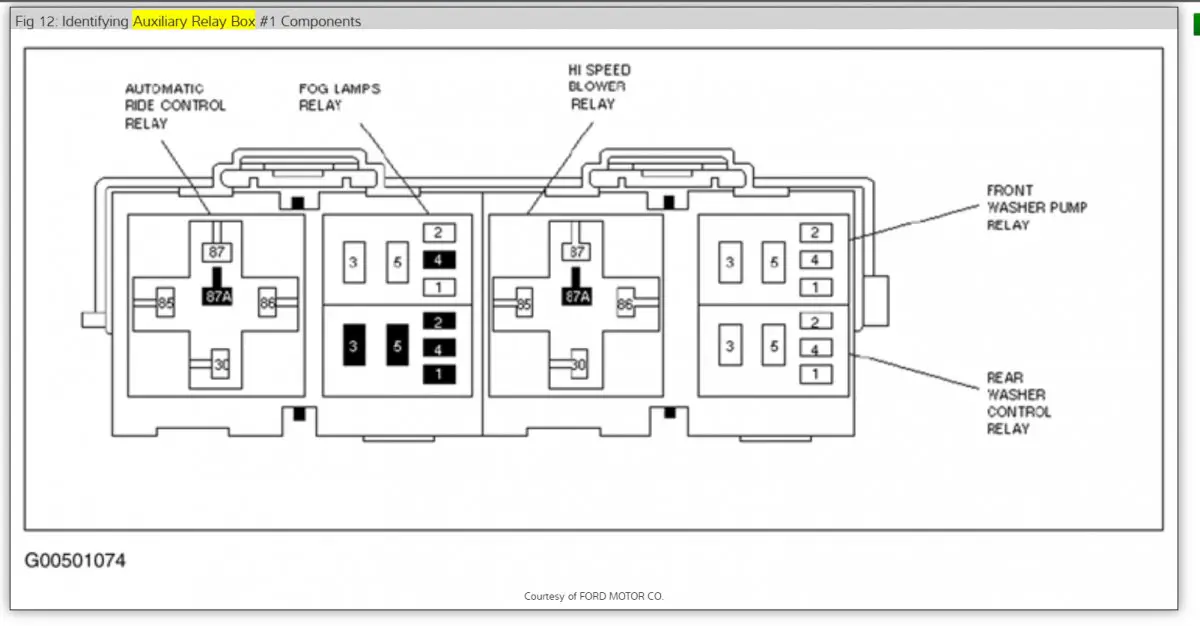

The only diagram I have of the relay box under the air cleaner box looks like the following. As you can see, more than one position uses same type relay so you can swap one of same relays to the other position for the pump, though this type of relay only costs about $10 3rd party on Amazon or less on Rock Auto so I just keep a spare new one in my glovebox.

Might also want to see if power is getting TO the pump itself on the harness connector. The circuit is interior fuse panel (hot in acc or run), to washer pump relay, (which is activated by the GEM based on the setting of the MFS triggering that relay, then to pump and pump negative a good, low ohm ground connection. PDF wiring diagram attached... trace the circuit, see where power stops, or a frayed wire could cause too low a voltage to get to the pump to spin it up... less common, but as vehicle age and so does wiring and connectors (even from rodent damage) that becomes a little less unlikely.

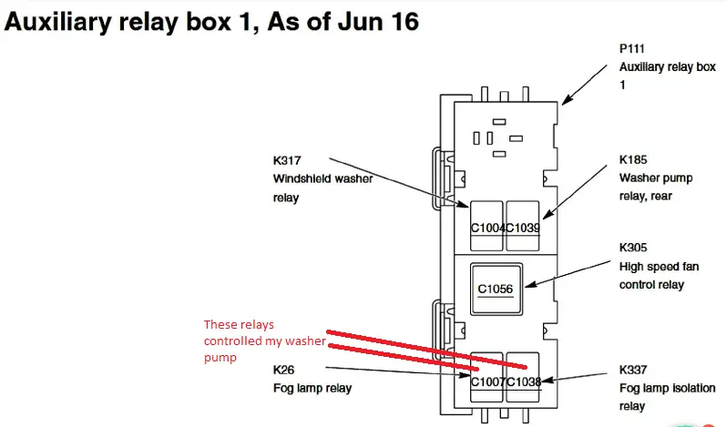

Problem resolved, thanks to all for the info and tips. A bad relay was found in the location of the bottom relays shown on the picture and drawing. The drawing appears to be labeled incorrectly as the defective relay was at C1007.
