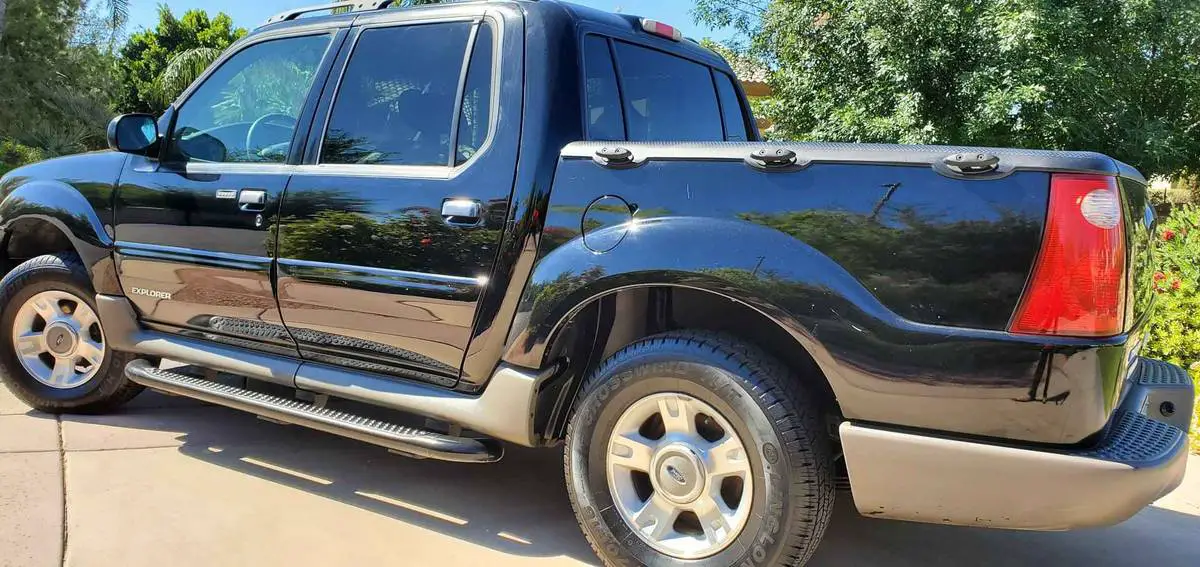

Good looking S/T. How is the roof paint? And the interior?
The interior latches "may" have been damaged when someone attempted to open the doors from the inside. Replacements are available. Be REAL careful and LEARN what needs to be done to take off the interior door panels BEFORE you go prying them off.
The body bushings are well talked about here on the Forum.
Welcome. Nice looking ST.
Roof paint is quite good. Hood paint is all scratched up (like someone was tossing a clipboard up there). Interior is dirty. Plan to remove and paint the panels. Thanks for the caution regarding the door panels.
