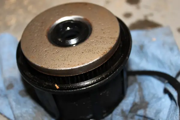

Well it was fuel filter time a few days ago and boy was that a mess. I am not even sure when the last time this bad boy was changed....
Dirty Dirty Bowl
New Filter and a bottle of liquid inspiration...
i was haveing some cold start issues. started checking around and with the 6.0 i have there is alot of sticking issues with the internals after alittle research and this link http://www.powerstroke.org/forum/ge...otella-t-5-10w-30-you-will-probably-like.html i made the switch to the t-5 and havent had a problem since.
ohh and what a dirty fuel bowl you have. i have been changeing my filters every 3 oil changes little suckers arent cheap though dang diesels
Tommorrow will be the test. It is now cold out around the same temps where I was having starting issues.
Hopefully it was just so dirty that it was part of the problem. It has started great since the filter change.
17 degrees today and started very good. So that had to be part of the problem

This truck is the 7.3 and ever since I changed the fuel filter and cleaned the fuel bowl up it has been great. Only one hard start which was when I forgot to plug up the truck.
