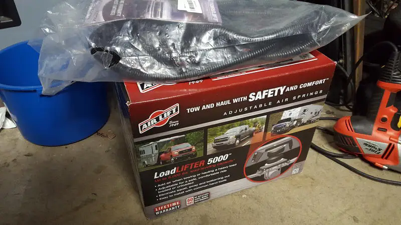

Upgrades:D

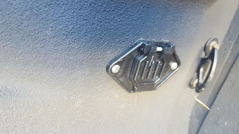

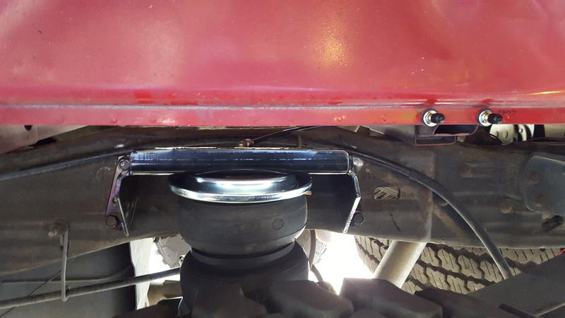

Installed my upgrades this weekend.
Lance Camper harness
Airlift Air Bags

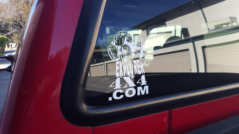

Dose of street cred:D

The sticker adds 10hp :D :burnout:

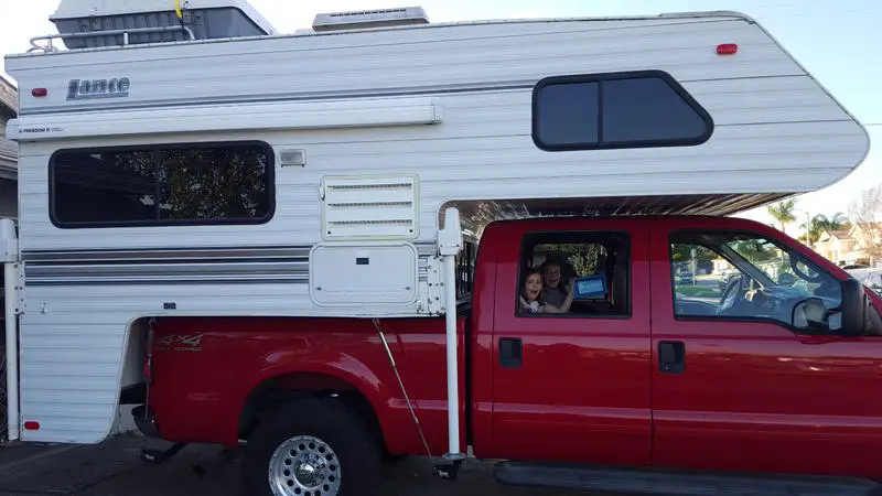

:D added some cargo

So without making a new thread, here are the highlights of the camper.
1999 Lance 820
  • A/C / Cold weather package
    Oven/ 3 burner Stove / Micro
    5 cu. Ft fridge/freezer
    Dual propane tanks
    3400 watt Generator :thumbsup:
    Outside shower (inside of course too...duh)
Got it from a 1 owner retired firefighter. Which is getting weird, because the truck was originally owned by a CHP officer.
You might want to stick something under it, like a rubber mat to keep it from sliding around.
It also appears too close to the roof, lances in that era was not designed for a superduty bed, and needed a space (mine was 2x4's) to keep it from hitting the cab roof.
Otherwise, good find!
Time to add another battery in the truck bed for it.
I actually have a 4'x6'- 3/4" stall mat in the bed under it. I just ordered new torklift tie downs as the happy jacks that came with I had to modify with extentions to get it home. There is probably a good 2" of space over the cab (I think lance made the change for SD in '99), and with camper not fully secured in the bed it bounced pretty good on the way home in spots. However, never made contact with the roof of the truck.
Picked up a factory rear sway bar, I'll be adding and I'm ordering Rancho 9000XL tomorrow for the truck.
Only other concern is tire capacity. I'm running D's with a max load of 3195lbs. This is a heavy camper, so may have to think about a tire change soon. Thought about swapping with JP, as those a rated at over 4k lbs each. But a bigger tire I don't need, and the thought of putting a abused 12-15 year old tire on the truck with a camper, scares the hell out of me.:(

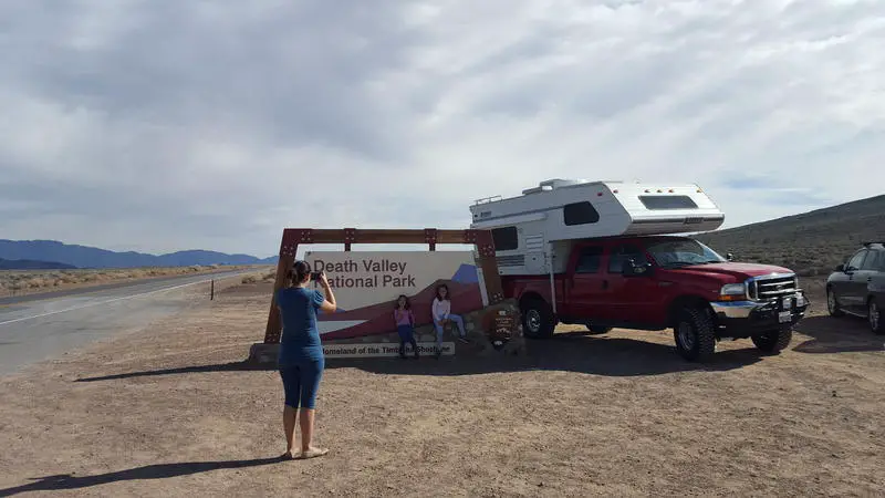

Inaugural trip:D
Already do have carnage though. Lost the front driverside sway bar bushing. Tried doing zipties, but after a good bump that blew apart :(
So tomorrow will be a fun day going home...in the wind:thumbdwn:
