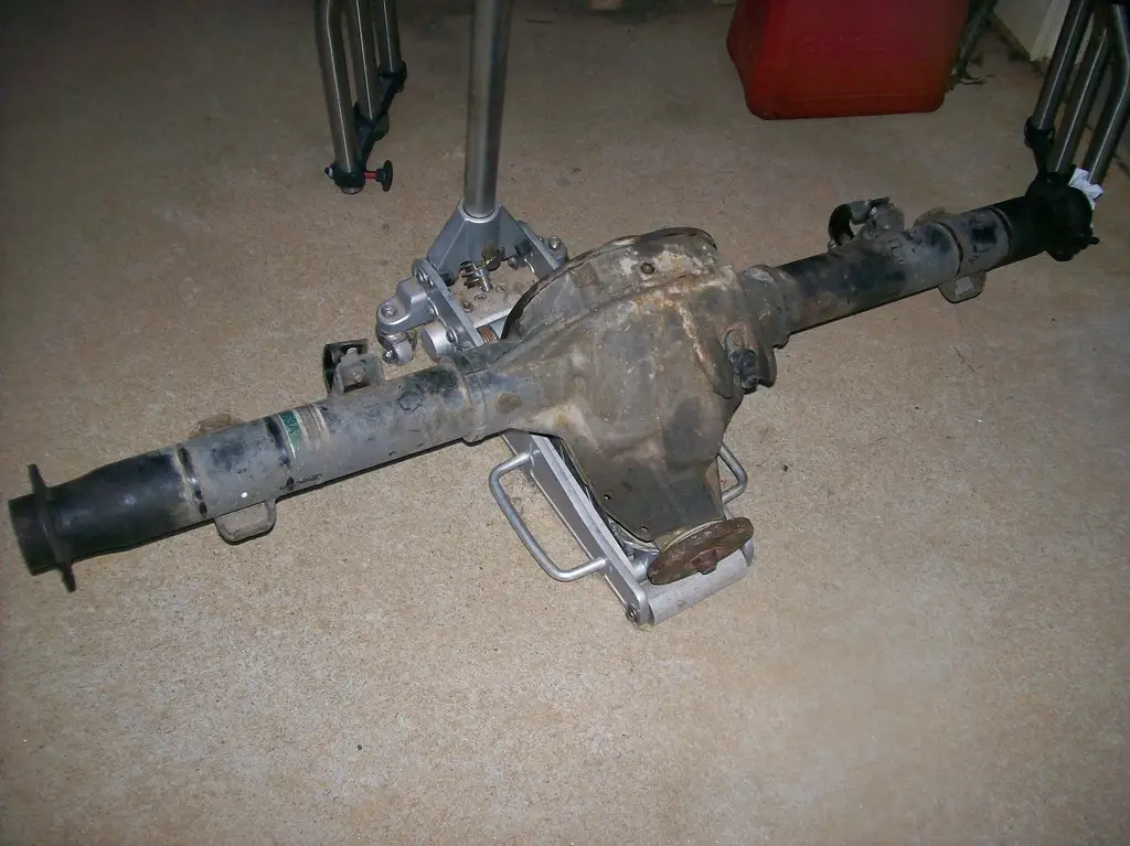

I find myself dealing with an axle that is out of true at the flange. Due to this I began the effort of getting a new axle or whole rear end depending on what the yards have at what price. So like most I start with the door sticker to identify what axle I need. The door is tagged D4 (3.73 LS 8.8). Being thorough I crawled under the truck to get a look at the tag. Now this is where the crazy starts. The tag is stamped S661A and there is also a sticker near the right spring ubolt with the same number. Since the tag did not match the door I went on line to Ford to see what the tag number corresponded with. Ford tables show this number to be from an 82 - 85 Ford Areostar. On top of that it also shows this to be a 7.5 rear differential with 4.10 gear ratio. So since the truck is 4 wheel drive we all know the front and back have to match regardless of the 8.8 or 7.5 aspect of the difference. SO...what I really want to know is what is the easiest way to figure out which gear ratio is correct. Can some of you tell me what RPM your ST turns at 60mph with a 4.10 gear and some give same info running the 3.73. Running stock size tires would be necessary also for apples to apples comparison. I know I can pull the cover and count the teeth but of I can be relatively sure (as in a big gap between the information) I can pick up a whole rear end and get on this thing quickly. I kind of need the truck to be able to haul the rear end and tbh I hate the idea of pulling the cover, counting the teeth, putting it back together just to pull it out a day later. Also out of curiosity, does anyone know if a differential from an Areostar could have even been used in the truck. Thanks in advance.
