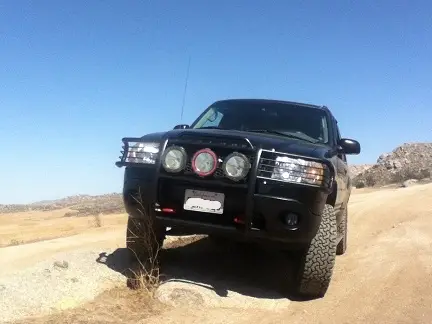

So plans on building a bumper fell through due to money and i picked up a brushguard really cheap on cl so just going with that for now. Have done other things on though. Added tow hooks I had forgotten I had in the attic and painted them red. Installed 3 rugged ridge hids on the brush guard. Also added another leaf to the leaf springs and got more lift off it so had to do tt to match. Changed the oil in the differential and took the opportunity to paint it red since it was rusting some on the side. Also riding around w/o the spare since I'm more local now. Other than that just routine maintenance and changing the lower the lower thermostat housing.

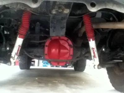

Little update this afternoon. Installed 1 1/2 in spacers in the front to eliminate the rub at full lock, and they have worked BEAUTIFULLY. Also got new front brakes and finally bled the whole brake system. That made a huge difference in stopping, while bleeding there was a lot of air when doing the rears, not so much in the front. Also installed rancho shocks up front, the longer ones to help with the TT front end. The shocks combined with the spacers have helped the drive a lot, especially on turns and on dips.

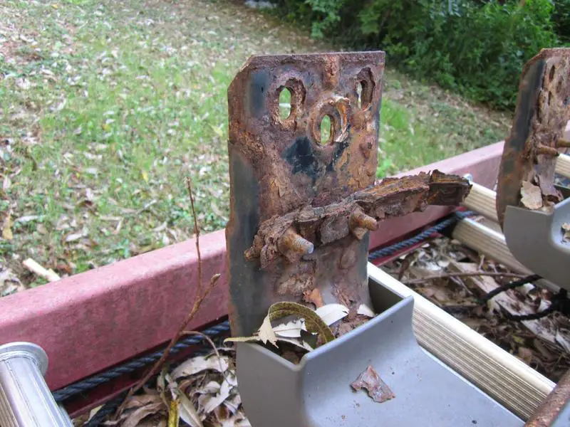

I didn't want to hijack the Sport pic thread, so I'm posting a pic of my old steps here. There's a little rust, but most of what you see on the brackets is my old rockers, still clinging on. Ahhh, the joys up the Northeast.
Overall:
And a close up on the brackets
If you want them, they're yours. Just PM me on where to send them, and I'll find out what it'll take to ship.

I figured I would actually check out your thread frankcal...It has come a long way in a little time. What type of brush guard do you have? I have been looking for one on CL and eBay but I'm not sure how interchangeable they are for different vehicles/brands.
Thanks, yeah it has happened pretty quick after searching through this site, it gets addicting. I have a hunter brush guard off of ebay. I'm not too sure, but I don't think many other brushguards are interchangeable. Because of the way then line up and hug the body, but the best way would be to check em out in person. They may not line up perfectly, but would be a heck of a lot cheaper then new.
I found the Hunter Brush Guard on eBay...it's going to be about $180 shipped. I think I will order it when I have the time/money. Thanks.
That's not bad I think I paid over 200 for the one I got of eBay a while ago.

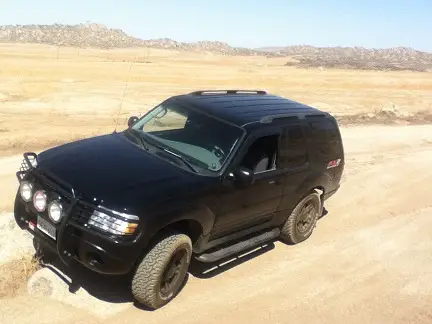

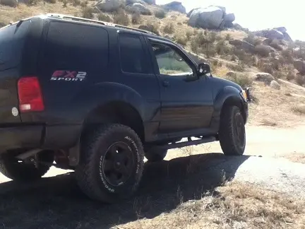

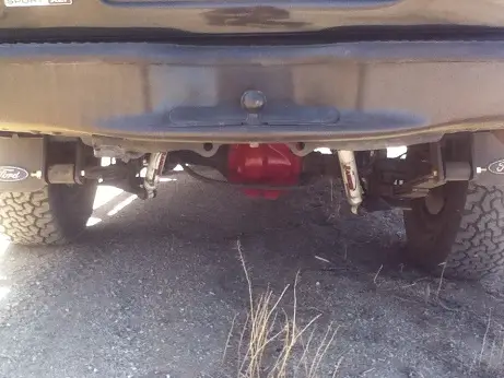

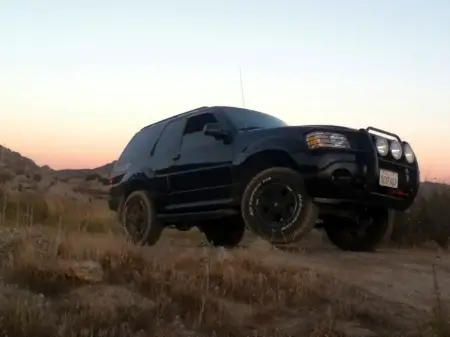

Just finished installing some shackles on the rear to finally level out the height, well mostly, the front still is about an inch higher but im just gonna keep it like that for now because I dont feel like going to get an alignment any time soon since Ive been there like 5 times in the last month. The front sits at 38 1/2 inches from floor to top of wheel well and the back is 37 3/4. So its good for now. I went with shackles on ebay that I saw another member had gotten. The company is pro form fab, and they are made pretty hefty. I went with 1.5 inch ones just because I didnt wanna do the full 2. They cost me 44 and picked up some grade 8 hardware for 22 so not too bad.
Other updates on the list are replaced master cylinder, front brakes, rebuilt the front calipers, inner tie rods and got spacers put on the rear, and fuel filter change as well as bleeding the whole system which took me 2 days due to issues.
All repairs are mainly done now, the only thing left on my list is U-joints and regular maintenance and hopefully nothing else pops up so I can start saving up for other mods.
Anywho, here are the pics as always
Close up of how the shackles looks
Just all around shots of it poser flexing slightly. The funny thing is after drove off the rock my tires spun a bit and threw dirt all inside my car filling the seats, floors and dash all full of gritty sandy dirt.
