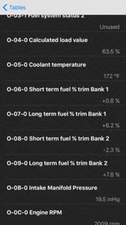

Mine is the v6. And the the only thing worse than people taking 9 blocks to hit 30mph are the people who take 30seconds to make a right turn. And I don't really care about the money I could be saving, I just assume if mine is that much worse than everyone's it probably means something isn't right and I like fixing problems.
Hook up a scan gauge so you can see live data. Look at your fuel trims. It's possible you're adding fuel to compensate for a vacuum leak, while not setting any codes.
Thanks i think you are on to something! I've kinda always suspected I've might have a vacuum leak, hasn't happened in a while but last winter it would die on me in extreme cold (would always start back up) any advice on what numbers to look for in the data or how to find a vacuum leak?
You can spray carb cleaner around the engine compartment, if there's a leak, it'll suck in and the engine idle will change. Spray in "spots." Though you can have a leak and not detect it this way.
If unmetered air is entering your system, the O2's will pick it up and add fuel to the mixture. Positive numbers on fuel trims means fuels being added, negative fuel trims means fuels being reduced.
Fuel trims should really be zero, but they'll bounce around.
There's long term fuel trims which depict how the system has been running. Then there are short term fuel trims which show what's happening right now.
Plus or minus 10 points is supposed to be within tolerance, but to me, that means there is a problem. There shouldn't be more than a 10 point swing. So if the LTFT is -5 the STFT shouldn't be more than +5.
Ideally, long term will be close to zero and short term will go from -1.5 to + 1.5 or so. Somewhere in that area.

Thanks so much for the detailed response, sounds like you really know your stuff. I hooked up my ELM 327, its an iphone compatible OBDii scanner, Im not sure its perfectly reliable but it seems like its pretty good. Here is everything I got, this first picture is a minute after driving at 45mph in regards to the fuel trims.
and here is the complete list of data after a 5-10 mile trip around town that included a few stops
Fuel trims looked fine. They can be high when first starting to drive. But yours were still below 10%.
