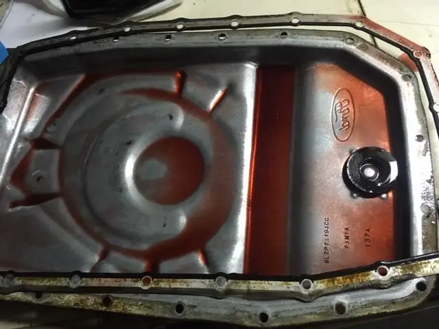

Tips on this one would be to use OEM filter as some of the aftermarket fluid intake ports are located high and in the front of the filter. It would be best to have one that utilizes the filter fluid intake on the bottom of the filter that fits necely in the dimple in the transmission pan. Be aware that you will need to get the level correct. Too little or too much will cause problems with the transmission shifting. The level will also be different once up to temperature. Refill while cold up to get a registered reading on the dipstick then cap up and take a ride to get temp up. Leave running in park and take dipstick reading. Fill to fill line. I'd check the level a few more times after a few days. Always check when hot idling in park. Oh, and watch the exhaust pipe near filler hole/dipstick it is HOT.

I usually measure how much fluid I collect and refill same amount.

so ive done a search and cant seem to find much info. has anyone done a transmission pan drop and filter change on a 2006-2010 explorer with the 6r60 6spd transmission? my 2006 EB currently has 62,000 miles and id like to drop the pan and change the fluid and filter. I will be using motorcraft mercon SP with a motorcraft filter and I have a fluid pump to fill it back up. my question is has anyone else done this on their own? or is everyone going to the dealer? how much fluid will I need? just wondering if theres any problems I will run into. thanks
Yes, I have done it. It's pretty straight forward. Easy to change, especially if youhave a fluid pump. Drop the pan, remove the filter, make sure the o ring came out with the filter. Lube the o ring on the new filter and install. The fill plug is on the passenger side front of the transmission. You take it off and remove the yellow dipstick out before filing. If i remember correctly, it was 6 quarts of motorcraft sp trans fluid. Other than not having a filter neck. It's just like the older rear wheel drive trans changes. Have fun. It's not bad at all.

There is a thermal valve in these transmissions. A flush doesn't clean the filter and it won't go through the cooler either unless the transmission is up to over 180 degrees. That's pretty hard to get while it's hooked up to a machine. Best bet, drop the pan and change the filter. These transmissions will hold up a long time by doing this.
