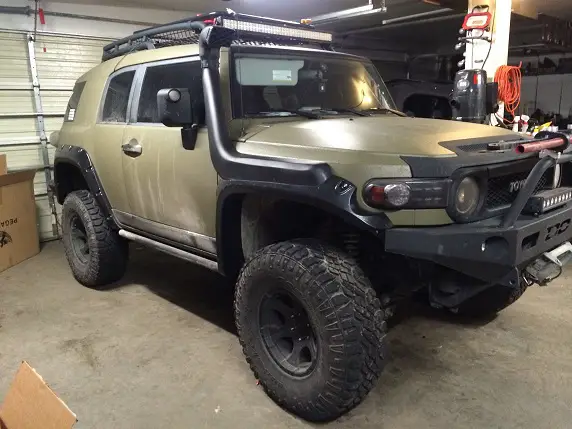

Here we are in November 2018, I am back on EF!!!
202K miles now on the Fj Cruiser she has been a VERY good truck and my wife and I have had our 10 year anniversary!!! Wow how time flies..I'm a very lucky man!!
ALOT has changed, lol like everything since then. Now RCX 6" lift stretched out to about 7.5" with Fox coilovers
FJ sits on 315 tires with body mount chop
Now green Monstaliner paint/ color change
Front and rear camera's
Custom front to back, nothing left untouched except the drivetrain :)
I have a replacement transmission downstairs for her, the factory unit needs a rebuild and some upgrades soon
You could say we have done some more work to her over the last 10 years :)
Still my wife's daily driver, we live off grid North Idaho, 4wheel every day:

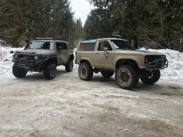

meanwhile the 31 spline 8.8 in my Bronco II continues to have no issues LMAO
I am always teasing my wife about her Toyota and how much the parts cost and how difficult they are to replace! HAHAHAHAHA
