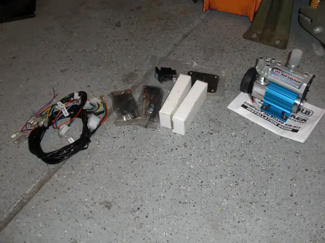

the parts:
ARB mini compressor, front, rear, and compressor switches, ARB wiring harness, pressure switch, and solenoids
Where to mount our compressor? I think this will work!!
I used a stock bolt that was already on the firewall, and I made 3 new bolt holes with a threaded insert rivet gun for the other compressor support bolts:
Only one new hole and threaded insert pictured. Sorry, Thanks again Harbor Freight, this is a WICKED tool!! So many times this would have come in handy!!
I wont bore you with the details, this is a very straight forward install, wiring, plumbing.... I spent ALOT of time making sure this is done the way we want it, only 3 wires are required for hookup, a ground near the compressor, a battery 15 amp feed, and a interior light wire for the switch illumination.
I soldered all contacts, I carefully routed all wiring, I modified the FJ dash to fit the ARB switches, and I took very special care to make sure the air lines are secure and safe... I have never had an air leak or wiring issue with the ARB's in my BII, I dont plan to start now!

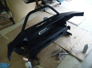

First we found a Demello winch bumper on Craigslist a few months back, in the middle of a blizzard, for a STEAL of a deal...this bumper (as it turns out I found the build later on the intrawebz) was in a wreck, then rebuilt by a local fab / wheeler guy and sold to us for profit...he made the bumper stronger then it was from Demello and you would not even know it was damaged at all by looking at it,
top notch fab guy with a wicked ass supercharged 3.4L SAS Exo caged 4 runner + craigslist = HAPPY US with a bumper we could afford! Cost over $1100 to get one of these to our door here in CO, we paid $600 I think

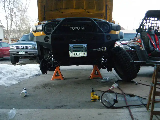

So I removed her OME springs and factory shocks...at 72K miles the front shocks are toast
I compressed both OME coils and installed the new Bilsteins
Now they recommend the lowest setting for this application, well I chose to bo up to 1.75" lift adjustment to get her front end raised up a bit
I also retained the Toytec 1/2" billet spacer... so these shocks lifted her front end back up about 1.5", due to increasing the spring rate
the FJ now has about 2" of downtravel and about 6" of bump... thats okay we like lift around here and with the new bumper and winch, the extra spring tension rides REAL NICE

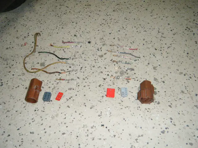

Junkyard is your friend, cheap source for male/female waterproof wire plugs and pins. I always have this junk laying around just in case!!
Wired up the truck side also for future use:
