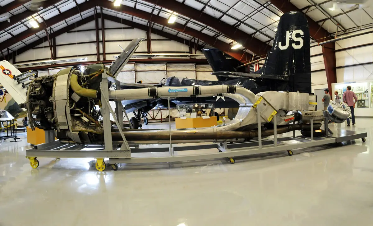

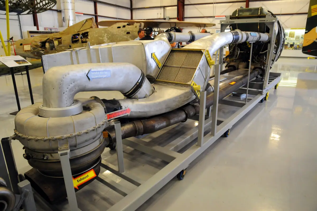

Hello Phil.
Since you live in Colorado Springs (and if you're interested), you could visit the National Museum of WWII Aviation and have a look at how Republic solved the problem of high altitude power loss in P-47 Thunderbolt, affectionately referred to as the Jug. The airplane dominated the sky at altitudes above 25,000 ft by incorporating a turbo supercharger that ran the entire length of the fuselage aft of the P and W R-2800.
P-47-powertrain_DSC_7265-66-pano (2).jpg 1_P-47-powertrain_DSC_7262 (1).jpg 0_P-47-powewrtrain_DSC_5382-crop-1024x739.jpg

Awesome post and on-target point. Also good to see appreciation for the workhorse that was perhaps the best-engineered (but, ahem, least "visually appealing") fighter of the war, responsible (all versions) for both more air victories and for bringing more pilots home safely than any other.
But back on topic, agreed that supercharging is the true fix, the one that will work.
