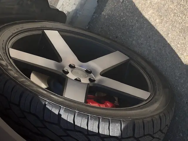

Order you some 1.37” long lug nuts. Those 2” are WAY too long.
Not gonna lie, when they mounting them at 7 pm after staying open late to do so for me, i was thinking wtf. But did not want to drive on winter tires any more so let it be. Future upgrade, and will mention that before they put 24s on my F150 later this week.
Problem solved!
Much better.
I agree. Thanks again for the suggestion i had 24s put on my F150 yesterday and they were going to do the same thing so i called them midweek and had them get the smaller nuts for both. For anyone who also owns an F150, here is how they look on 24s in 305-35-24 Falken Ziex tires. I’m very pleased with the ride despite having concerns about it (stock is 20 inch).
