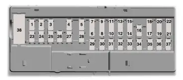

Thanks, blwnsmoke! I did the Sync system reset when I took delivery of the vehicle and purposefully didn't let my dealer strong arm me into registering for Ford Pass. (Man was he ticked. They must get a bonus for signups :rolleyes:.) Toggled off all the "send what I'm doing to Ford" options in the touchscreen menu. So, I'm not sending data to Ford -- that's good. But the modem is still pingable by AT&T. Diving into APIM diagnostic mode, the modem still appeared to be live.
So I found a temporary work-around for all those folks who are as frustrated as I am that Ford won't man up and give us control over our own vehicles... In the passenger compartment fuse panel, pull fuse #8/9:

Now when I go to the FordPass menu in my Explorer and select Connected Settings (or something similar -- not in the car atm), I get a new message that pops up and tells me it's unable to locate the modem. Here's the downside: Pulling that fuse also knocks out the trunk's power liftgate. Next weekend I plan to sign up for the 72 hour subscription to Motocraft's service info, locate the telematics control unit, and unplug power directly. (I've seen it located behind plastic in the passenger foot well in other Fords and the police version of the Explorer from '19, but need to confirm for '20.) Endgame: no power to the modem, restore fuse 8/9 (and my power liftgate). We'll see if an error message gets thrown.
