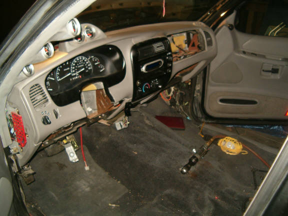

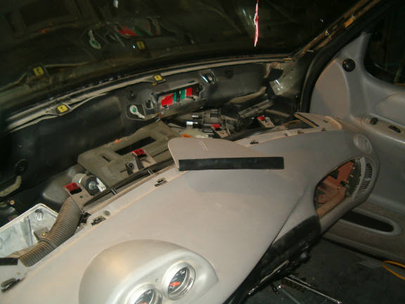

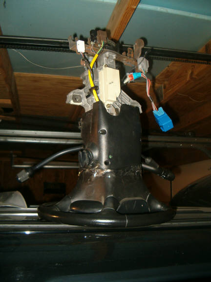

Thanks to xzibita--I am on a roll again. I have the steering colum removed as a module, and the dash is propped up by a box on driver side, totally loose on passenger side--I can see the needed heater core cover bolts--now to loosen the box from under hood , so I can pull it back and access them.I just hope my intake manifold can stay on.
I was following the prcedure in the service manual, for some reason it led me thru removing airbag-steering wheel, then pulling column. This workaround is where I was confused.
There are 5 bolts,transmission indicateor screw, 7 harness plugs, all keyed, and the transmission linkage to disconnect. I made sure to tape the steering whell into position, so it wouldn't rotate and damage the clockspring.
I need to start taking pictures, I'll get more as I put it back together--
This is where I am now--

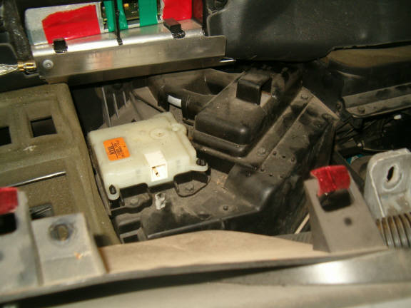

Are you going to replace the blend door while its all apart?
I like your gauge pod, BTW.
Thanks--about the pod. It is for mustang--fits nicely (or at least it did before all this--). It requires a hole thru dash though---
About the blend door, well I don't have another one. It wasn't in the plan. I was hoping mine was the stronger type lol.
ok-quick, how can I check it?
One of the Blend door fixes talks about how the blend door always breaks in the same place. I think there is a picture to illustrate it. If I didn't replace it, I would at least see if I couldn't reinforce it somehow. JB Weld is a miracle material. :D

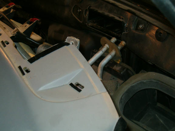

Hello--man, I am on the homestretch now.
I gotta take a lttle break--those under hood nuts threw me.
They were all double nutted underneath the blower housing---

Someone at Ford decided they were a little too easy to get off without the extra nuts. :p: Ha Ha, what a bunch of pranksters. :D
I had the pleasure of doing this on my 1987 VW Fox ... back in 1994 or so. A month later VW issued a recall for the problem, and would have replaced it for free. :mad: Sounds like the same job here. Steering wheel and dashboard had to come out. Took two of us about 8 hours to do it.
Now I'm wondering if this is where my coolant is going very slowly.
