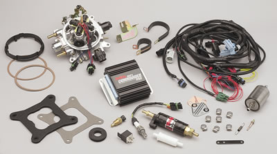

There is an easier way....
http://store.summitracing.com/partd...908331+4294840125+4294889096+115&autoview=sku
