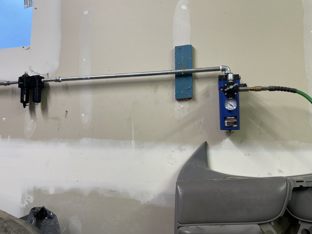

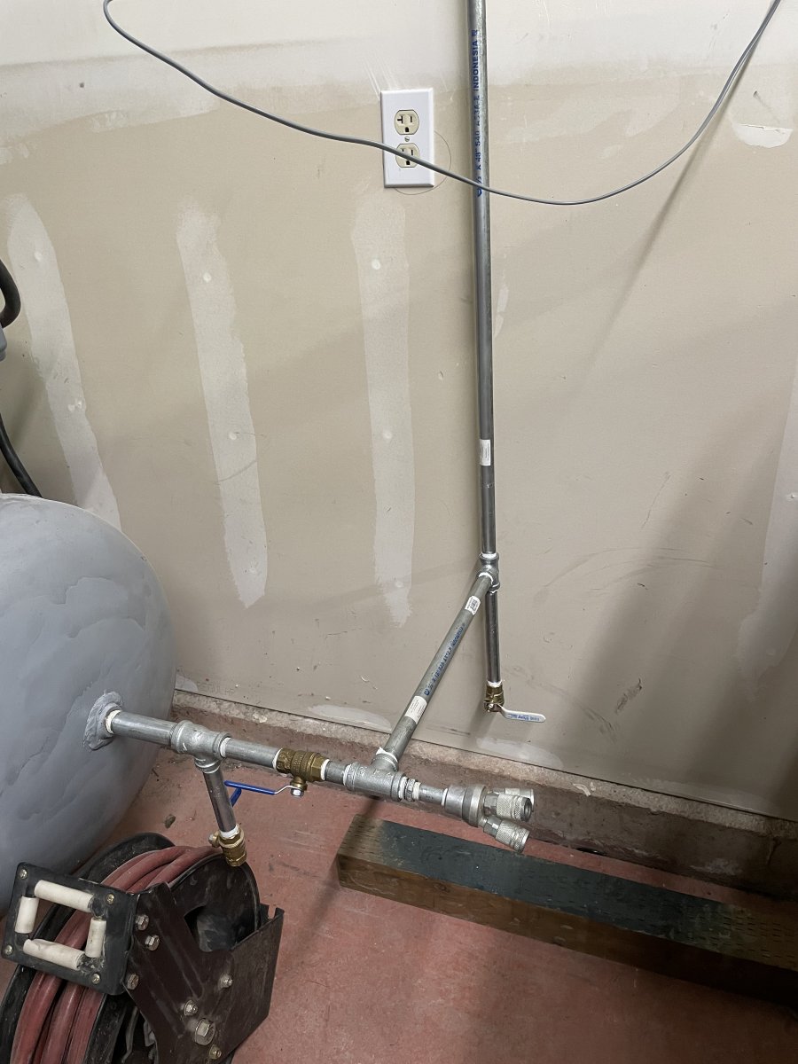

So we are finally putting down he paint! We ran into a snag. First off it’s 100% humidity here for like weeks now.. huge snow then warm weather we have heavy fog every day (we live near a 45 mile long lake) and it’s been raining on and off for weeks. Very humid! The ol Quincy compressor was putting too much water in the lines and when spraying the first set of primer we got some fisheyes
So upgrades for the compressor
Came sooner rather than later. The paint must be perfect on this truck!
Added some galvanized metal air lines with water traps and a slope to trap the water. Added a second dryer to the line
Repairs to the McNeil glass are done (small imperfections typical with fiberglass) the louvered sections are now gone and we are ready to primer the fenders bedsides and the bed parts…. If we could get a few days without rain that would be *****in! Someday I would Love to have a real paint booth…
Bye bye cosmetic louvered sections
If you look closely you can see small fisheye in primer section
Better now! This high end harbor freight stuff gets great reviews. I’m ordering another type of dryer we can add to the line to make sure no water gets through. Will not sacrifice quality! Never!!

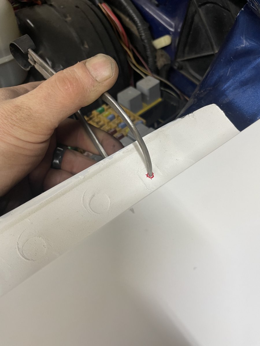

First up there is a little fiberglass
Bump that needs to be removed for the glass to fit
Multi tool makes short work of that
The first hole to drill behind the headlight has us lining up the header panel to fender body line

Fiberglass lined up perfectly, holes marked drilled and test fitted
The Merlin product line seems to be good stuff. I just picked up a 60 gal compressor a few months ago. $150 for the tank and with a new compressor head. Needed a new 5hp motor, switch, and some odds and ends. The motor came off the shelf from an old Sears compressor with a rusted out tank, got a switch from Tractor Supply, and had to get a new tank check valve from Amazon. The regulator and rest of the fittings came from HF.
The Merlin pressure regulator is the same unit that is in the Porter Cable packaging for less money.
No hard plumbing like that for now, but someday I'll figure out where it's going to live for good. I also want to add an aftercooler and water trap between the pump and tank to help cut down on moisture that even makes it there.
