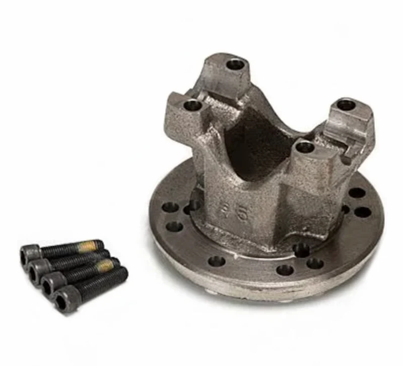

And then there is this can of worms:
Which converts the cup to a u joint
And now you need a complete shaft with a u joint or cardan joint for lifted dudes….
96 sport rear driveshaft works great as a front shaft after you install the cup adapter and shorten the shaft
