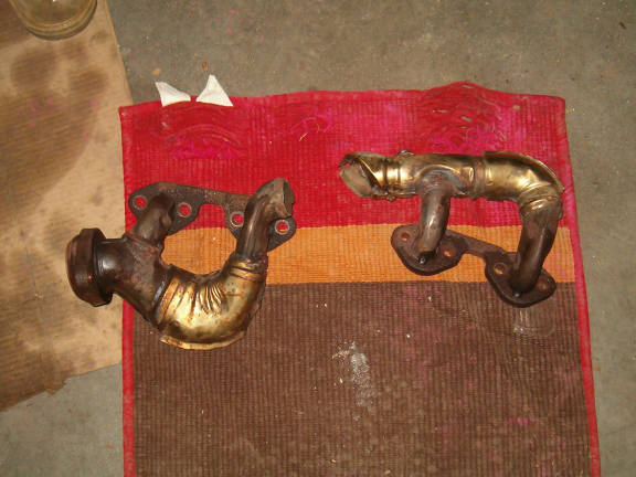

Searched for the source of the tick, including listening as best I could for an exhaust leak, but it just sounded like it was coming from the passenger side valve cover (using my stethoscope).
