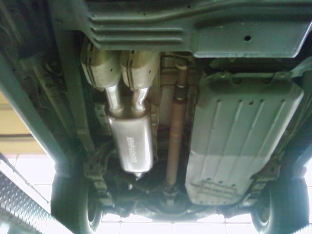

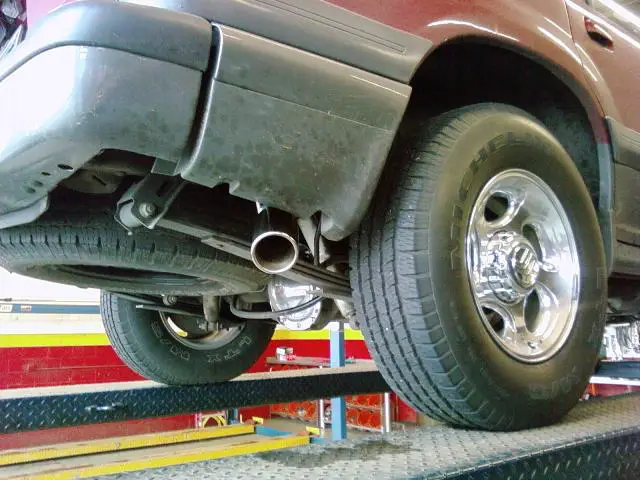

On my '98 5.0 Mounty, I recently had the stock exhaust system upgraded with a Magnaflow 12368, which is a dual 2.5 in and single 2.5 out, with new 2.5 stainless tailpipe and stainless tip. Got rid of the resonator, too. Sound and runs awesome!!

Exhaust
Leon63,
Did you keep the stock manifolds? Also, what kind of mileage are you getting?
Apparently we live about 15 minutes from one another so driving conditions are probably similar:burnout:
I have stock manifolds which are leaking a bit; my plan is to get TM headers this summer.
I had the muffler work done at Goofy's in Glenwood -- extra clean job.
