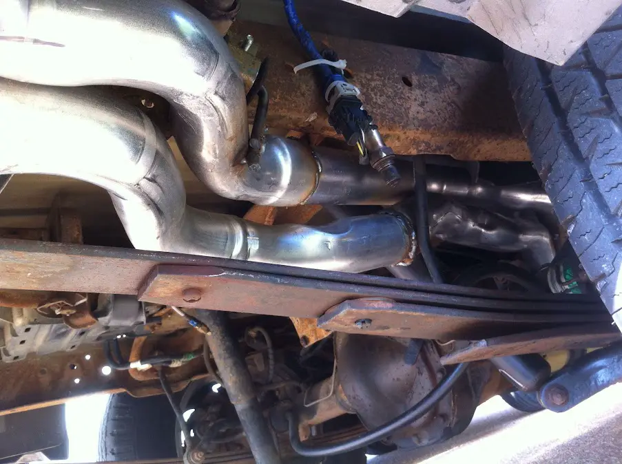

Sooo, you ran duals all the way out the back then?
Yes... 2.5" to clear everything without a major PITA instead of trying to fit 3" even tho I don't have a spare or anything:

No problem!
I think the exhaust guy did a decent job but there are some funky indents and **** on the pipes but oh well... only paid $170 for everything so can't complain too much I suppose, lol.
I wanted to exit before rear tires but running boards in the way and don't want to remove them lol.
Maybe I am seeing things, or missing something, but is that just an 02 sensor hanging out back there? whats the point of it all the way back there?
Yeah what's that all about? ^^^
