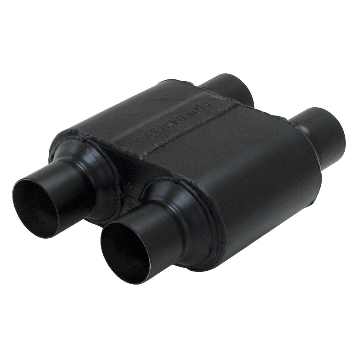

Flowmaster now offers the 10 series in a dual 2.5'' In/Out format. I just about messed myself since i have these on my '05 GT and love them. Got one ordered in for my Explorer now that'll replace my Dual In/Out 40 series and will have a cross-over installed as well. Stay tuned in the following weeks for a video. I can't wait to hear the results.
