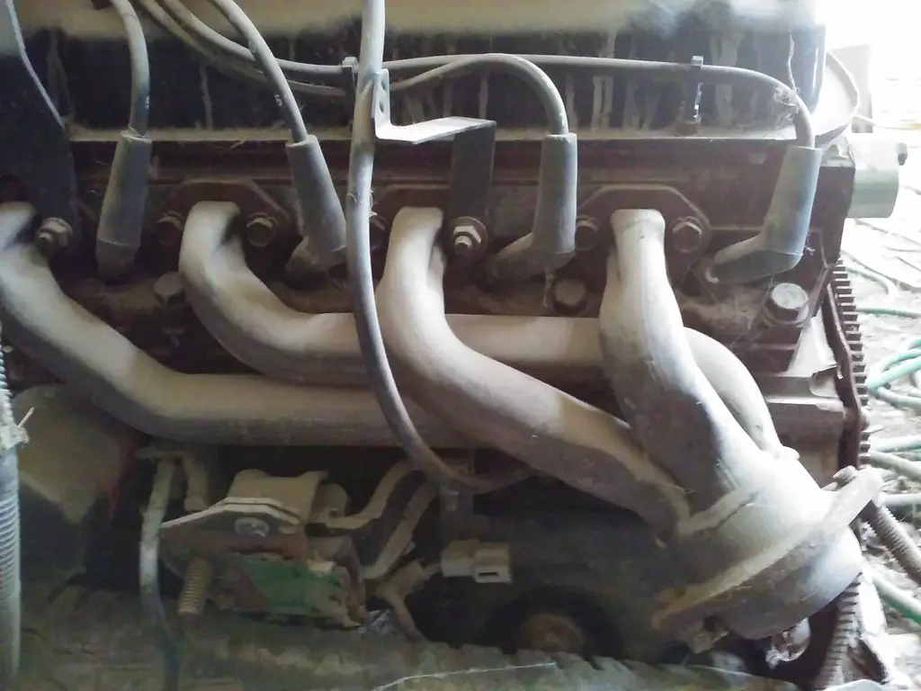

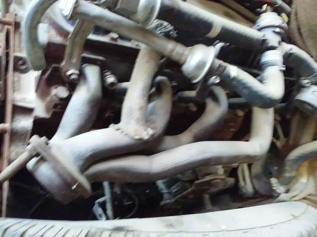

While I agree with everything you said.. A can and a set of torque monsters just isn't in the budget. Now.. On the subject of headers, I do have access to these. I don't suppose they'll at all will they?
