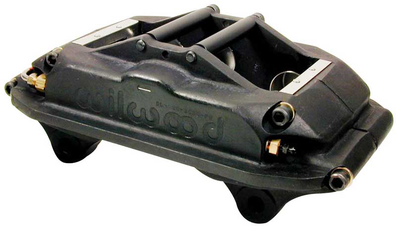

I have a Wilwood GN III caliper that I will make another bracket for the front, but those have almost the same area as the 65-82 Corvette calipers(too big).

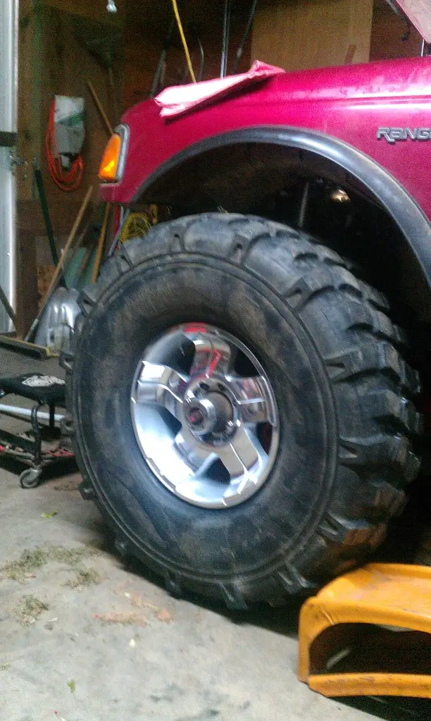

Remember, I'll be running a front axle from an f350 ( Dana 60 king pin high pinion) and a rear axle from a E350 van (dana 60U with disc brakes). Believe it or not, I've got a 15" wheel that will fit and clear my big brakes. I bought the tires before i bought my rims as I got a killer deal on them. Btw, the tires in that pic are 210 lbs each without the rim, but those are not going in my Trac ( but it would be Kool to see it :D) I plan on getting a set of ebc yellow pads and a set of slotted rotors front and rear. That with braided lines will be the extent of my brake upgrade...

I was not thrilled with the OEM pads that came with the rebuilt old Corvette calipers. I bought replacement SSBC calipers which are a hair smaller, but these take a GT2000 pad, not really that big. The Wilwood calipers I'm planning for now have a 3/4" pad, the friction material. I looked for calipers to use that had the huge 1.1" thick pads. Those calipers had pistons too far from what I'm after. You could use some of those, but of course you have to fabricate brackets etc.
