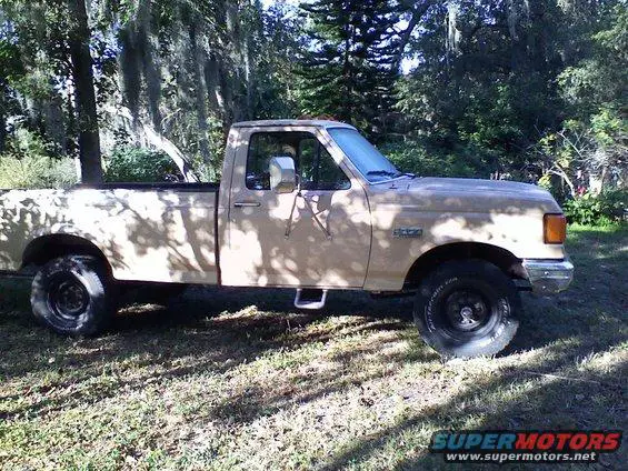

hi guys, not gonna lie this is actually in a 90 F250 that i swapped a 98 Explorer 5.0 and 4R70W into. to do the swap im running a 96 PCM to get around anti-theft. Im gonna be swapping the intake manifold soon to the earlier GT40 with internal EGR and now im deciding if i go further and get some power.
i figuered at least a couple intake bolts are gonna break off in the heads anyways so im probably gonna pull the heads and get them machined and upgrade the valvesprings since there the P heads. i also was thinking maybe it might be worth it to swap in a bigger cam while im at it. anyone recommend a nice cam?
truck is a 1990 F250 2WD so its pretty heavy. but its got 4.10 gears and sitting on 33" tires so it lets the engine rev pretty easilly. its got long tube headers going to 2" true dual exhaust. i have no idea what the stall speed is of the tranny and i dont really know the specs of the Explorer 5.0s so was wondering if you guys could help me decide
also is it worth putting larger exhaust valves in the P heads?
