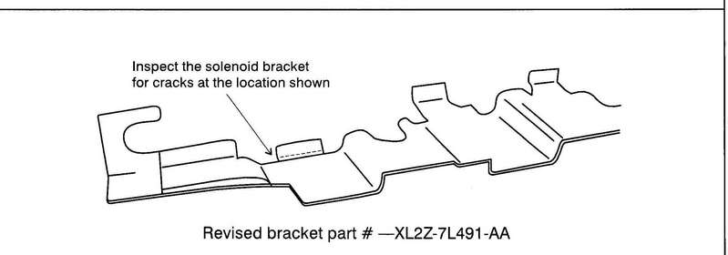

Did you check the resistance on all the solenoids?
well, i discovered one of my problems about 10 seconds after i got my new rebuilt VB out of the box. When i did my rebuild, i neglected to make sure the solenoid bracket as seated around the valve. it was keeping all the solenoids in the correct place but was keeping the valve pushed in instead of holding it.
Anyway, i got the new one up, got it all back together, filled the trans fluid, and away she went. shifts are solid and strong, no lights, and a happy owner. Kind of an expensive lesson in nomenclature and attention to detail... but i guess now i have peace of mind, and a properly rebuilt vb.
so........uh.....uh.....the problem seemed to be with the manuel valve????? uh....uh....
question on solenoid bracket
kean, i know it has been a while but could you explain a little more about the bracket keeping the solenoids in the right spot but holding the valve in,, many thanks, kjgces. ps, i'm fighting the same kinds of problems.
This picture is from Glacier991's photo gallery:
