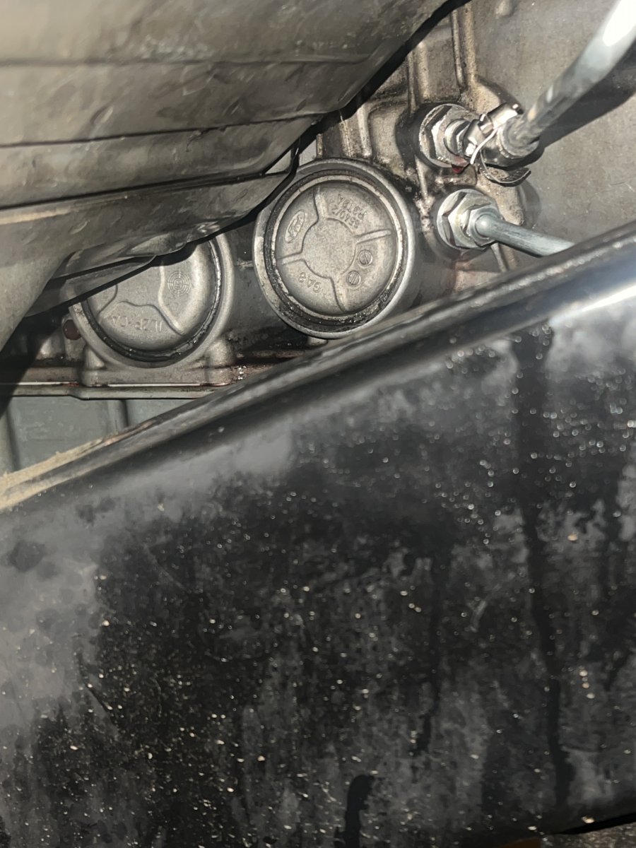

If I’m hearing this klanking sound while in gear that’s not engaged and when I cut it off. Makes me feel like the TC has come loose again and the nuts have backed off somehow. I’d think that would cause low pressure or shifting issues. I think I start by removing the starter and seeing if they are tight and I can rule that out. Or find and fix a problem.
Maybe by the trans sitting dry and fluids being removed that it did cause it to act up and I can throw a few hundred at the servos and bores possibly and the solenoid pack and valve body. I hate to keep dropping the pan and adding 5-6 qts each time. Eventho I can store it clean but always chance for contamination etc. Also I have destroyed my shop floor and many other things with all this fluid mess.
Or do I pull the tranny , take it to a repair shop and take one without a kiss or flowers !! After all the videos on this trans id think I could rebuild it. But the piece of mind and confidence would be lacking.

I'm not seeing what tester or gauge you're referring to. Air gauges will not work. I've been all through these trans and they're not difficult to rebuild. They're a single stack. It's a lot like those toys when you were a kid with the colored rings that were different sizes and you had to stack them on the little stick base starting with the largest at the bottom and smallest at the top. Except for grown ups. Follow the stack procedure and as long as you are fairly mechanically inclined you'll be fine. Most times you get in there and most of everything is in great shape. Usually the problem with these trans doesn't require any rebuild or anything at all. I would say 95% of issues with these is servos (majority), solenoids, or valve body. I would never buy a replacement transmission or send it off for rebuild knowing how easy it is to fix. OD servo fix is about $180 for the part last I checked. All of this info, common issue and diagnostics write ups, full transmission service guide, full rebuild guide, including pressure test procedure, fully detailed and illustrated with every single piece and every specification, every possible detail about your transmission in my Facebook group for download, for free. Not to mention access to detailed info on virtually every inch of the vehicle itself. I'm really trying my best here...

Should I contact syd for a possible cheap trans ? Start with the Servo 1st and or bore too. ? Then see what happens and if need be , price a rebuilt kit ?
