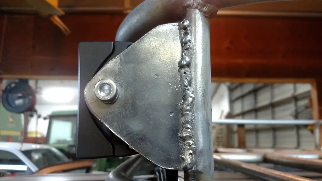

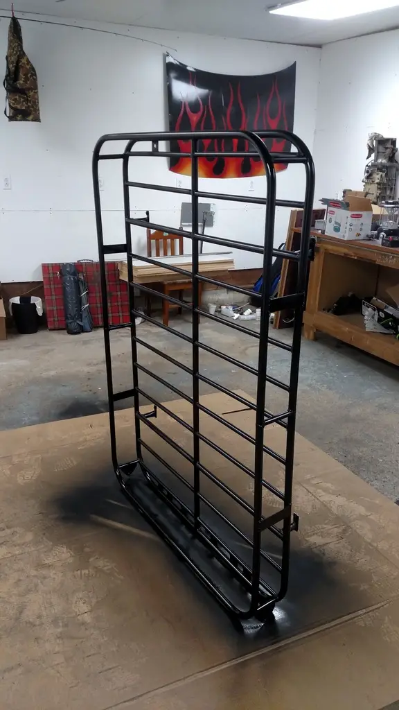

More recently however, I finally got to do some fab work and paint! It started by getting a $1.50 bar of steel, cutting, grinding, and then a little welding and small electrical work.
Don't mind the not so expert weld...

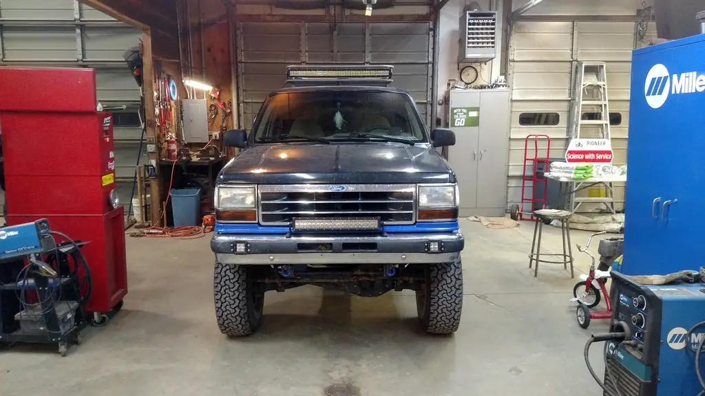

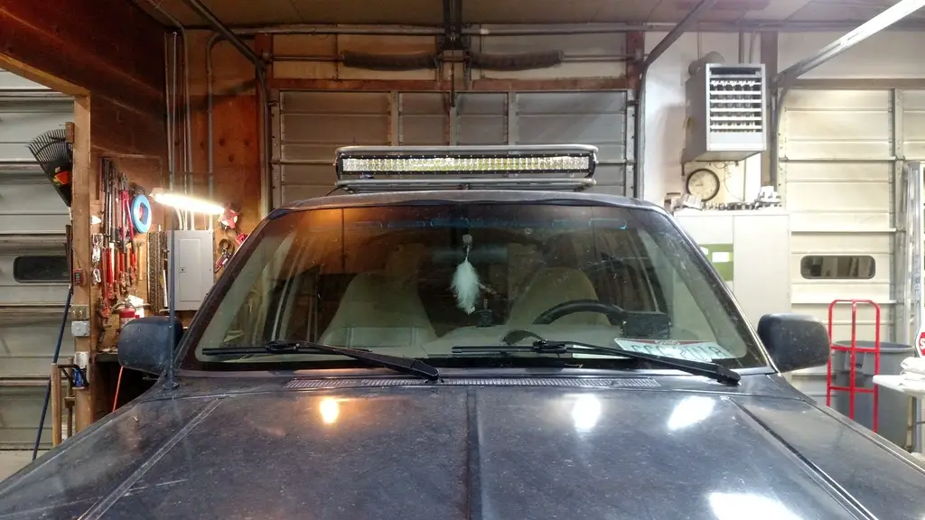

The 40" high-output LED bar is now in! 480w of LEDs turning night to day!
Still didn't like the "conduit gray" of the luggage rack, and since the bar was finally mounted, it was time for some paint. Started by removing the rack, wire brusing any rust that had appeared, throwing on a few coats of primer and then a few coats of satin black paint.
Still need to throw a few zip ties on the wires, but it's good to go, looks good, and works great!

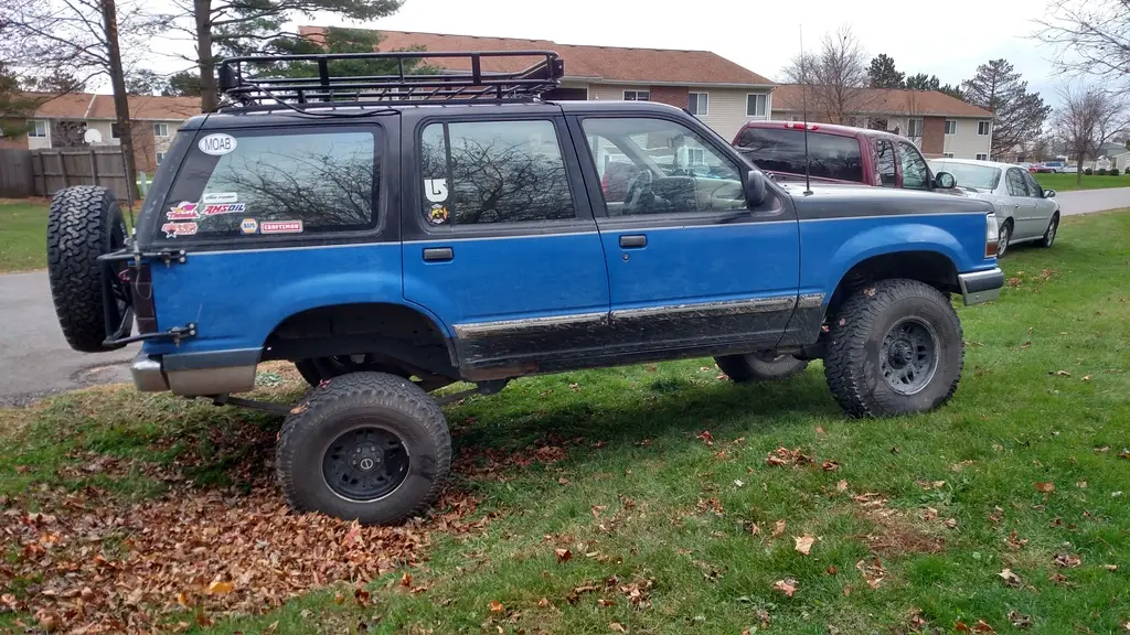

Just wondering how did you mount this on the roof. I really like how this looks.
Its all integrated into the roof rails that were already on the vehicle...I measured for the basket and fabricated it all first, fabricated some feet and slid them into the rails. Once they were in the rails, I set the basket on top, covered the truck and put a couple tack welds on to secure the feet to the basket where they needed to be. When that was done, just pulled the basket out of the rails and finished off the welds.
There should be a write-up somewhere in the build log here...
