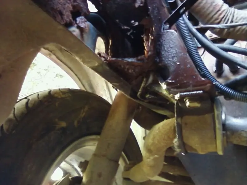

the cancer is out of the car and the new framerail is almost ready to go in. I will finish getting it ready tonight and weld it in tomorrow. my brake pads are in as well, so I might get to drive it tomorrow night.

I'm gonna go load up the progress I have so far. the cancer situation isn't quite done, but I'd like to show off the progress thus far
Here is the progress so far:

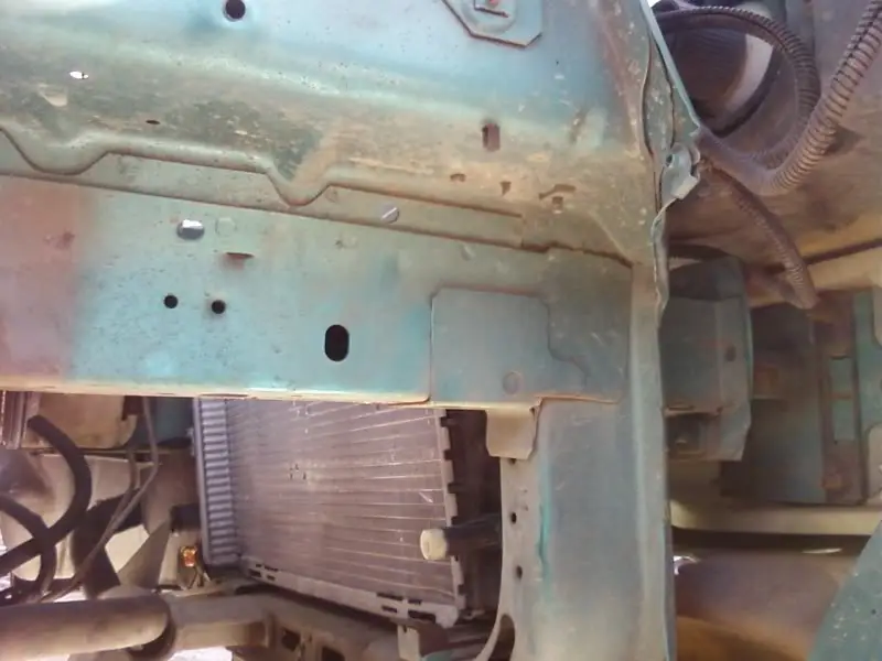

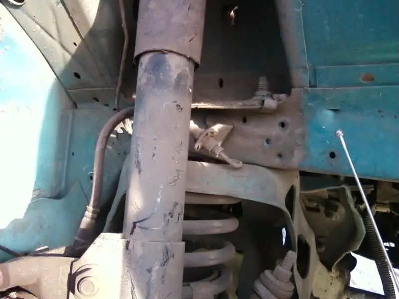

this is the donor for the frame transfusion
I ended up paying $30 for the piece. that's $20 more than I wanted to spend.
the '88 was hacked up, but the '93 was in great shape. the only hiccup is I need to make a drop bracket for the swaybar.

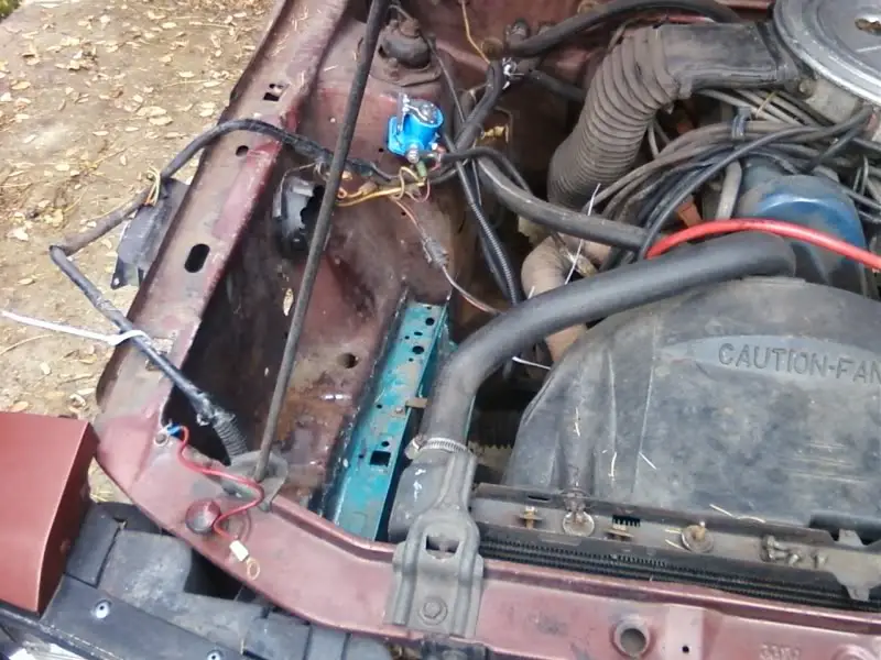

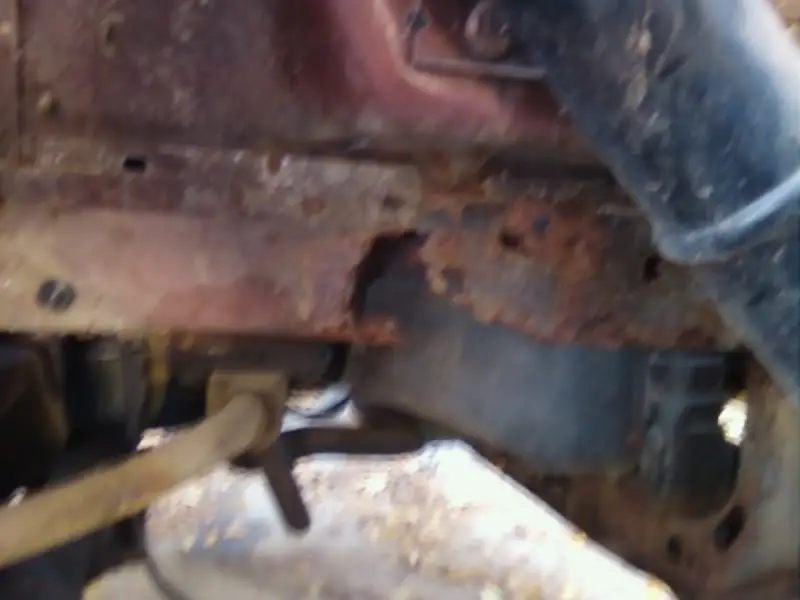

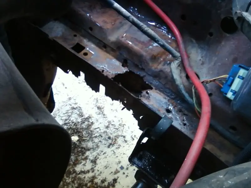

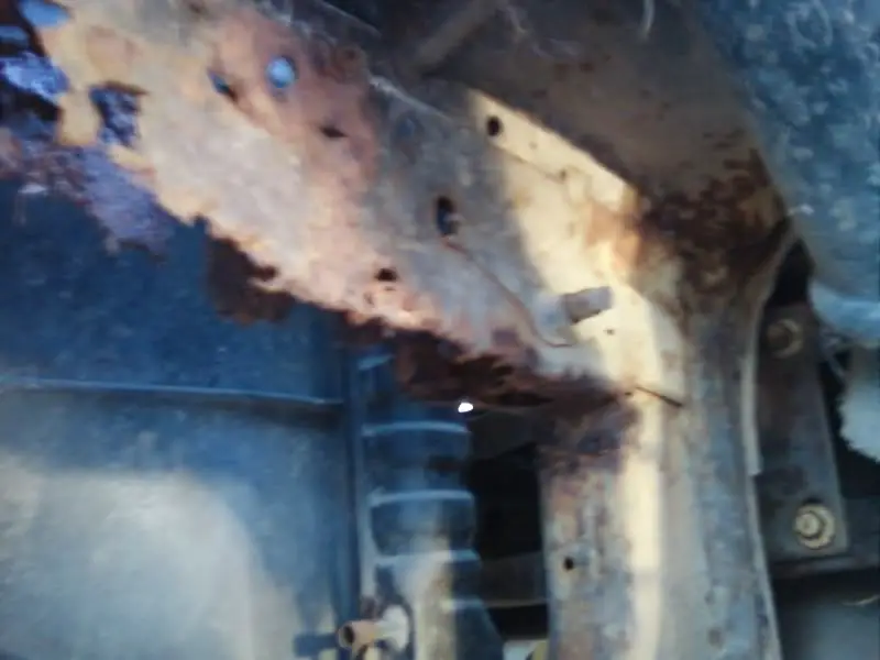

this is more of my damage
my dad helped me tack it in, and made me do the rest :p:
I will take more and better pictures when it's done and back together. that was a LOT of work, but it's definitely worth it!

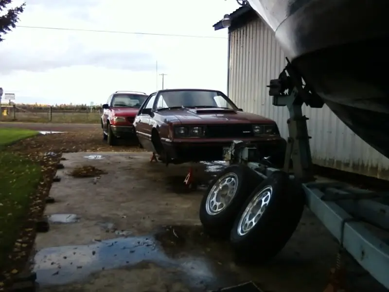

oh yeah, the pictorial update:
It ended up kinda ugly, but it's safe to drive on now
I was pretending to drive it really fast, cuz I had just washed the brake fluid off of the master cylinder and couldn't get the car to start ;)
