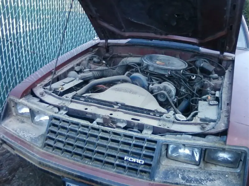

I then proceeded to pop the hood to assess the damage:
I need 1 battery, 1 starter solenoid, a new belt, and a WHOLE lotta cleaning!
I also found some Brown Recluse spiders. :eek: scary! Its gonna take a LOT of work, but I am way eager to work on it and get it done!

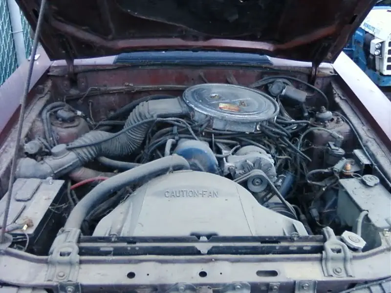

proof!
Its not that interesting, I haven't done much yet. but once I get it started, I'll start on the massive clean up
only so many ways to photograph a dirty engine bay
Lots of cleaning!
Fried the solenoid cuz I hooked up the battery wrong :scratch:
I didn't think about it, and matched up the colors, red to red, black to black.
hooked in the battery and smoke billowed forth from the solenoid. wasn't on there three seconds and I had that cable back off there. I knew I shouldn't have done that when the little warning flag went up when I saw that the "positive" cable was grounded to the chassis.
oh well, live and learn.

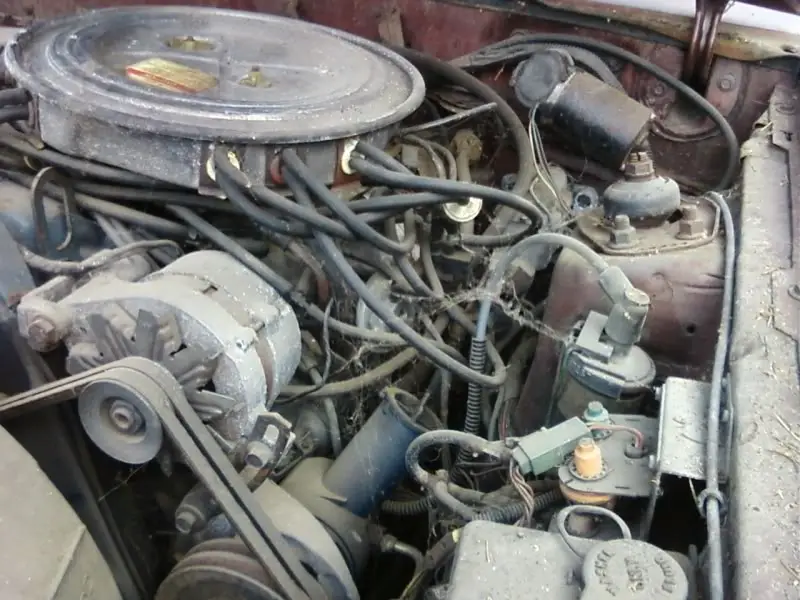

Ummm. Does anybody else see a problem here? Maybe I'm misssing something, but if that is a turbo car, 1.) Where is the turbo and plumbing? and 2.) Notice how the air cleaner is going to the inner fender, like a non-turbo car, instead of having a well-sealed airbox over the carb, connected to the turbo outlet?? Plus, the lid is only held on with 2 wing nuts. That doesn't seem like enough clamping force to seal against boost.
Admittedly, it does have an awful lot of vacum hoses; and the double v-belts seem like a bit of overkill for a n/a 4cyl.
...discuss...... :)
