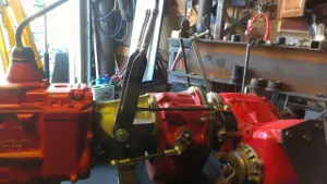

It's been a long time coming but the 302 is in, T18 and 203-205 doubled...made a flat belly x-member. all thats left is wiring, clutch slave, shift levers for t-cases and drive shafts! Pix coming soon!
t-cases with the Harbor Freight breaker bar levers
