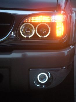

Quick question, on my header panel.. one of the adjuster's for the passenger side headlight is busted.. it Cannot be re-used. (I hit something and it broke the piece the adjuster goes through, so now it's just a hole with an adjuster laying in it..) With these projectors, in their one piece design.. is it alright to assume that none of the stock mounting points are used anymore, considering the new adjuster's are just those two bolts for each light.
From the looks of it, the only things they use now is the two top corner light screw spots.. and to keep it in-place, it uses the holes to push those "pin" like things through.
Nova mentioned to me also, that to aim these.. they have to be removed and re-installed every time you want to make an adjustment...... is this really the case, or is it just a really tight fit to get to the adjusters from behind the header panel? (He's one of the few that reported a horrible aim from the factory... along with his LED issue..)

My aim was fantastic from the get go. I still haven't adjusted the projector (with both halogen Osram Night Breakers and the HID). I might bring them down a hair but not sure I have to. I tweaked my highbeam down 1/4 turn this morning to try and make them more noticable since the HID overpowers them (as mentioned previously). I simply gutted both adjusters from the Diamonds and all the hardware I could from them. There is no need for any of those
YES, you must remove the headlights each time you need to adjust because you need an 8mm socket to turn the adjusters. No room whatsoever to get at them without doing so. I tweaked my highs this afternoon in no time. The lights do go in and out quickly so no hassle once you get the hang of them.
