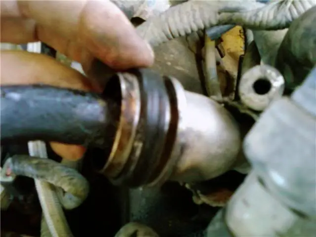

ok i checked that o-ring today and im not sure about it. if you look in the pictures you can see how i could move it up and down and where it was pretty loose around the tube.. is it suppose to be like that or is it suppose to be nice and tight?
see how much it moves up and down? is that normal?
also, there were no holes or cracks on the end of that egr tube.

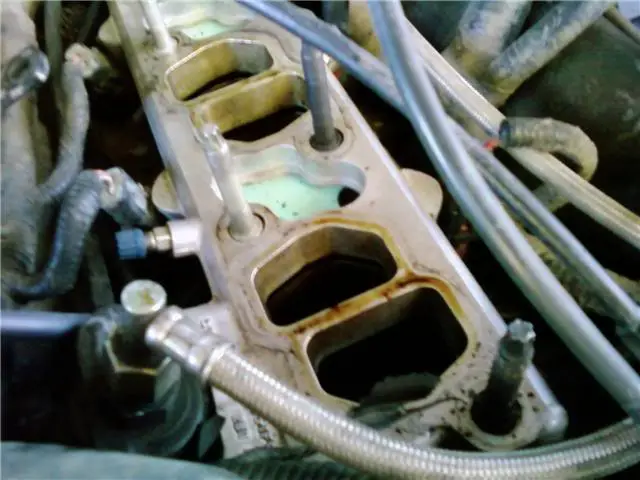

and another thing.. when i took off my upper intake, this is what the fuel rail looked like..
i replaced those rubber seals that pop inside the intake, should there be oil or whatever that is on the fuel rail? maybe a sealing problem?
well the egr tube sure has to make a positive seal. Its hard to tell from the picture, but I believe should be some holding strength to the rubber when you put it on the fittings. Not sure if the gasket is supposed to fill that entire gap. Its probably very cheap at the dealer though.
The gasket surface should be spotless clean. Is there any residue from the old gasket?
