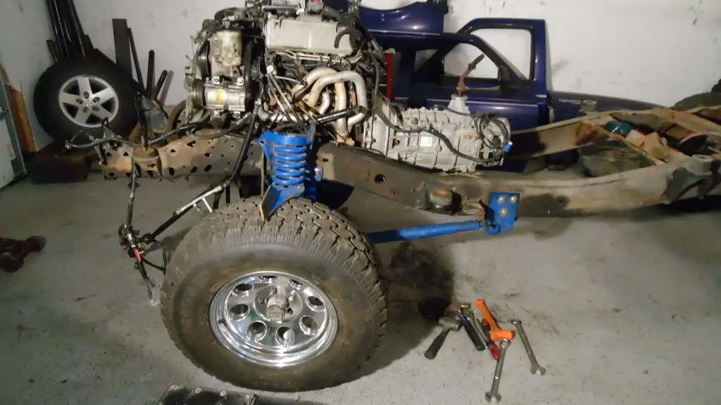

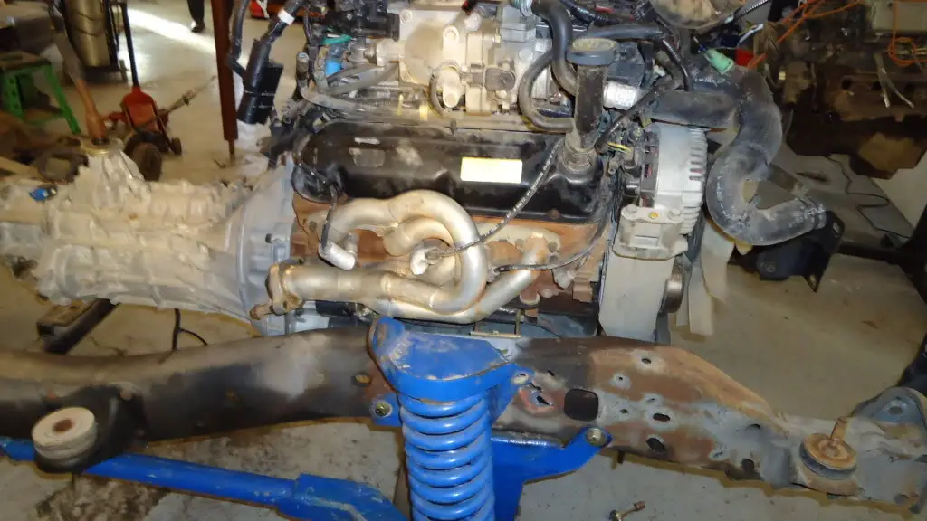

T-case is mounted, fresh tranny fluid. ferw things left and cab will get plucked on this coming weekend, I wanted to real bad yesterday but not gonna rush to much lol. Will get more pics asap.

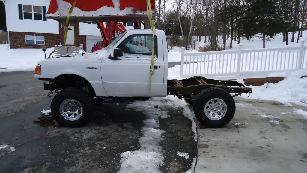

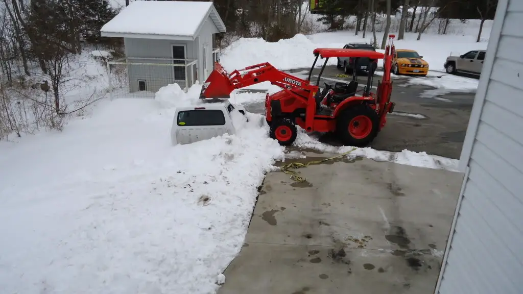

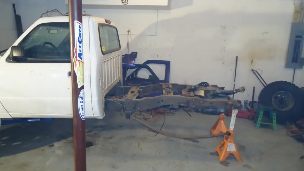

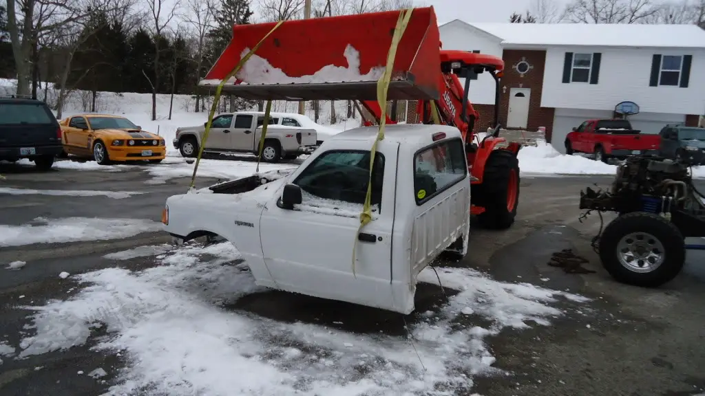

Ready to put cab on Saturday woohoo, tractor is at my house waiting!!!

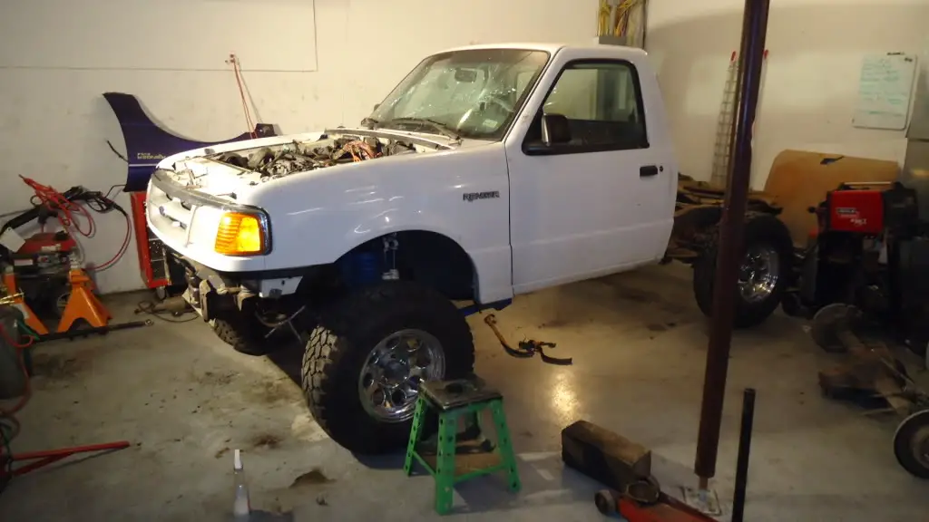

Few pics, little upset was trying to keep it kinda low center of gravity but had to put 3n body lift for cab to clear transfercase it wasnt something that could just beat cab bottom in a little.
Gman your exactly right, once all hooked up, got little body work to do then off to get paint, then put bed on, Im gonna work on it the rest of the weekend so I hope to get it most of the way mounted down and Hooked up, goal is tto start it next weekend. I still have tp switch rear frame cross members and mounted B2 tank and cut tabs off my disk brake 8.8 and put them on top and mount it as well.
Thanks for the comments..
I was able to get it down to a 2in body lift instead of the 3, so that made me a little happier! it cranks over with the key, I just need get my tank installed and it will run, then it wont be long!!!

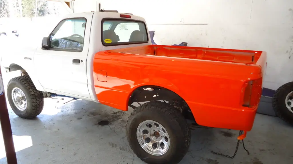

Allright, making progress order rear spring pads for my disk brake 8.8, gonna weld the tubes also I think, I had some Crow 4point harnesses that were mounted in my RZR, ordered the lower 5th points for those and a neck brace thingy to keep your head solid. Picking up my bed at school this afternoon and hopefuly getting B2 tank mounted!! Should be running by weekend.!!

Big change- Going to remove 4406 Tcase and install my Atlas 2, I think it will pull high range fine for tuff truck racing and then my low range will be sweet for trails, might get a narrow set of meaty 33s for trail duty!!!

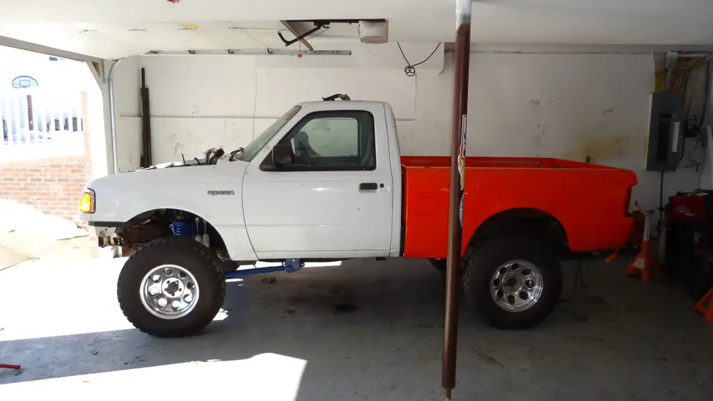

So far rear b2 tank now mounted, rear springs fixed *new rear bushings* eventually will get deavers but not yet. Temp rear axle for moving around is out, getting ready to cut old leaf pads off explorer 8.8 and mock it into place but not weld anything solid. I promise more pics Im taking a few today, here one from other day.
Its alive!!!!!!!!!! Runs and sounds good, need to get radiator mounted and will be almost good to go other than switching tcase hookin driveshafts up and doing brake work lol
bed is just sitting there i have clearance issue with tank
