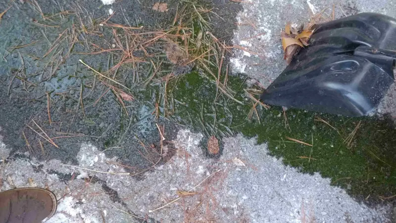

Regarding the 97 5.0 AWD with 130k that I backed into a light pole a year ago. Other than back and forth a few yards once every month or two, it hasn't moved since then (other than the 120 miles I drove it without issue the day I backed it into the pole). When I said a leak of coolant maybe I gave the wrong impression. The picture is from me standing in front of the truck after running it for 15-20 mins (while I was inside the house). More like a downpour than a leak. Also this had not happened any other time I run the car briefly over the last years.

timing cover is common leak point on the 5.0's and it they can pour out while running sometimes as significantly large sections of gasket can be blown out. If you have an auto store like advance or autozone, they lend out kits that you can pressurize up your cooling system and look for the leak. Much easier to pinpoint leaks with this kit than while running, in my opinion.
