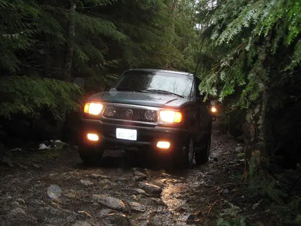

Yeah-I'm partial to the look.
I bet those were easier to install than mine. Because the KC's weigh alot (6" light) I had to make the brackets that go down to the bumper frame otherwise they would've bounced/wiggled themselves loose.

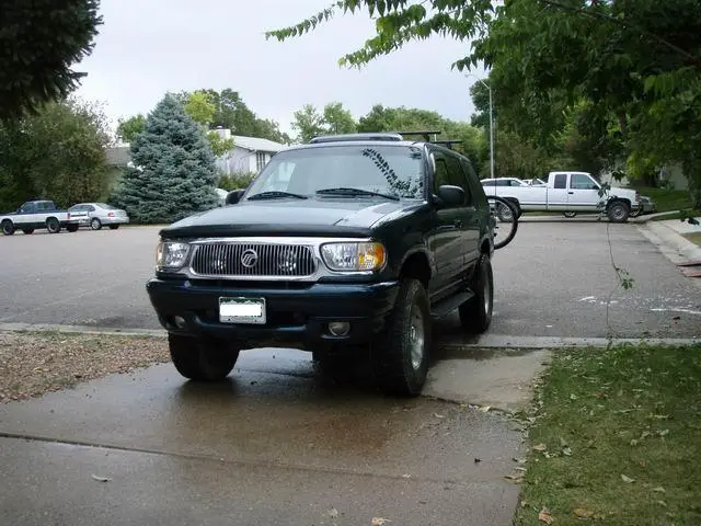

OK so with the light behind the grill is there a noticeable shadow caused by the vertical grill slats ?
I'm sure that there isnt even a shadow because the slats are so thin.
well about 5 ft. in front of the truck you can see the slats barely but out front ythere isnt
Nope
Keep in mind my KC's originally came with these on them
If you were REALLY close to a wall you could see a "KC" shadow

Well... I figure that if I need these lights, I'll already have my high beams on. On long, remote stretches of interstate I like running them, but I don't want to have to turn off my high beams AND then turn off the driving lights if a car is coming. This way I can kick them on and have 'em cut off with just the vehicles hi/low selector switch.
Technically, a 100W light is illegal to run on pavement, but I don't run my high beams with other cars around so I don't worry about it.
