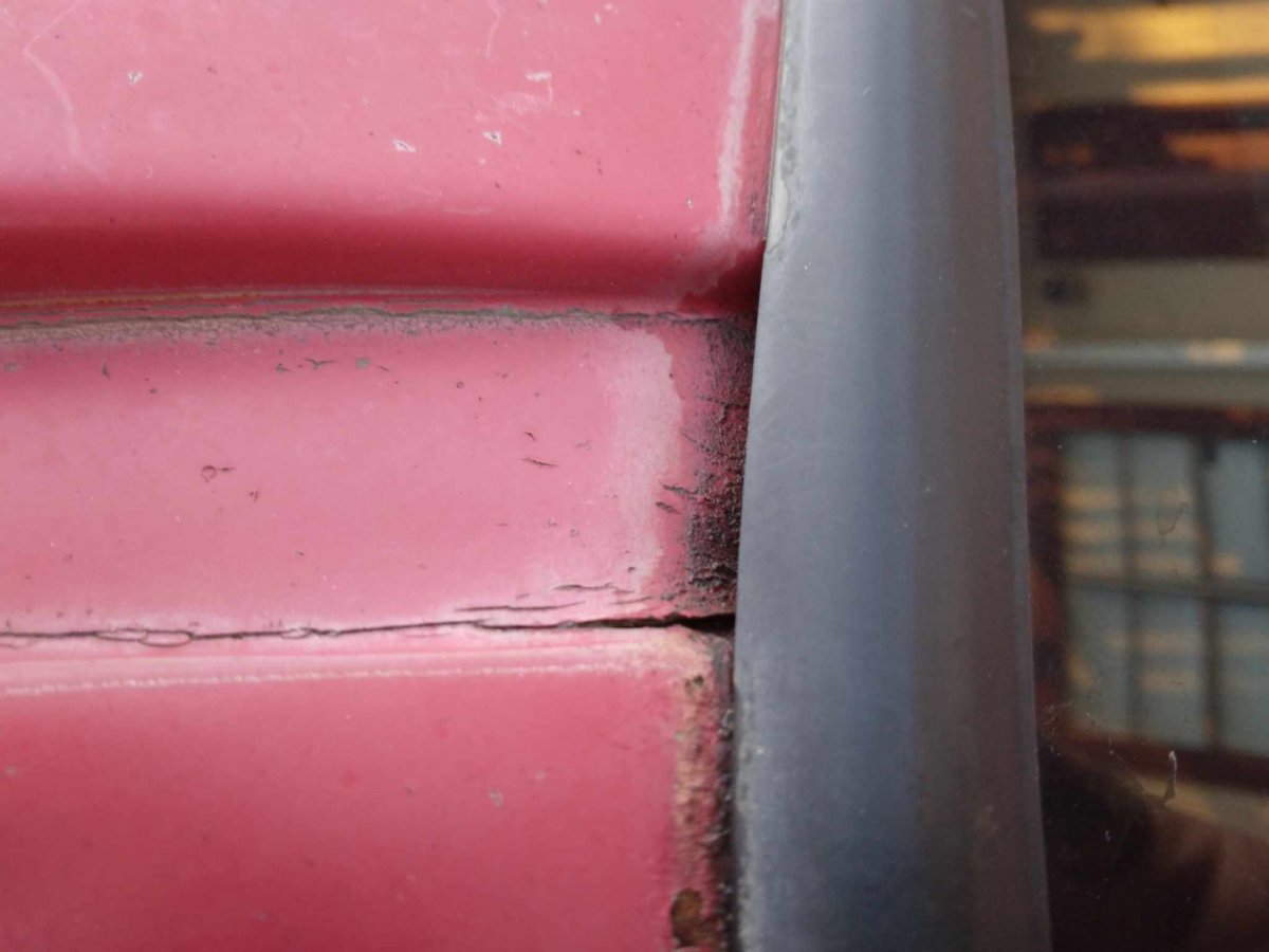

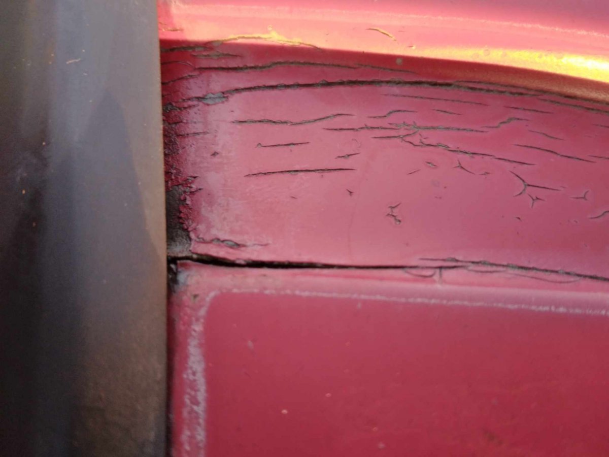

Ok, ill get it cleaned up and get more pics also how do i go about picking out the seam sealer without damaging things?
I suggested pulling off that obvious piece of seams sealer because it's not stuck to what's below, seeing if it's bad or not underneath is important for the future repair and paint.
You just want to seal up any exposed metal to slow any rust, until you can get it fixed right. I'm curious of how far under that crack it has let go, seam sealer is a poor product to put onto any bare metal. I used it over my clipped joint of my 99 body, after it was ground enough to spray with epoxy primer. There are products which are great for the treatment of bare metal prior to paint etc, the OEM doesn't use those in new production; the seam sealer goes right onto bare metal seams.
FYI, avoid silicone, that's great for making an aquarium, but it's bad for outside a car body. It interferes with paint like you here of Armor-all, creates fish eyes. Just use any RTV, which is not the same but is available in many colors besides clear, and some is cheap. Silicone gets hard and brittle fast, in sunlight maybe six months. I wouldn't use Ultra Black either, those top end products can be very tough to remove.
Will do also what type of rtv should I use I have ultra black and the right stuff gray 90 minute also can I fill the gutter where the seams meet with rtv? Or is that going to cause a problem
Yes, you can put it on the gutter to cover or seal if you pick off a bit of the seam sealer. I'd save the Ultra Black, I love that and use it often, but it's expensive and more permanent than other things. I'd see what Walmart might have, a caulk sized tube would be cost effective, or Lowe's, Home Depot, they would have lots of choices. They may have no RTV at all, and many types of sealant that are hard to judge. I'd look and see if anything is simple to locate, it should only cost $5-10 for a tube. The Ultra Black is around $17 for a tube from Amazon, I get that sometimes.
Yep Ultra Black is amazing also would the permatex right stuff gray that I have be ok or what should I look for?

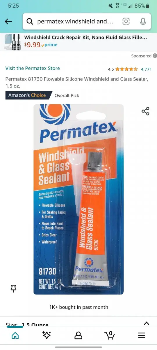

what would be the best option here?

That would be good for a crack in glass since it says it will wick into crevices etc. But that's expensive for a tiny amount and won't cover more than the small area of your leak. Any sealant like Right Stuff, RTV, silicone, or even caulk will do short term. But it sounds like you plan to do something sooner than years down the line, and the evident starting of rust says it will be smart to fix it before more years go by.
Cleaning it all well and sealing all the obvious problem surfaces should last for months or years, the quality of the product would make the difference of time. Really cheap stuff will degrade faster, actual clear silicone is fast to become hard and brittle in full sunshine. I consider that in indoor product only, my family used that to make a couple of aquariums. I helped a customer detail his motor home in the mid 80's, just the outside. It was faded badly, a beige color and took hours to buff it to a mediocre result. The windows and top vents, AC unit, were all caulked at the edges by clear silicone. That was a mess, it was hard and about half of it came off fast with a screw driver. The rest we spent a lot of time with cleaners, acetone was the best I recall(of what we had to use). Lots of rubbing by hand, plastic spatula etc, our fingers were very sore when we quit.
