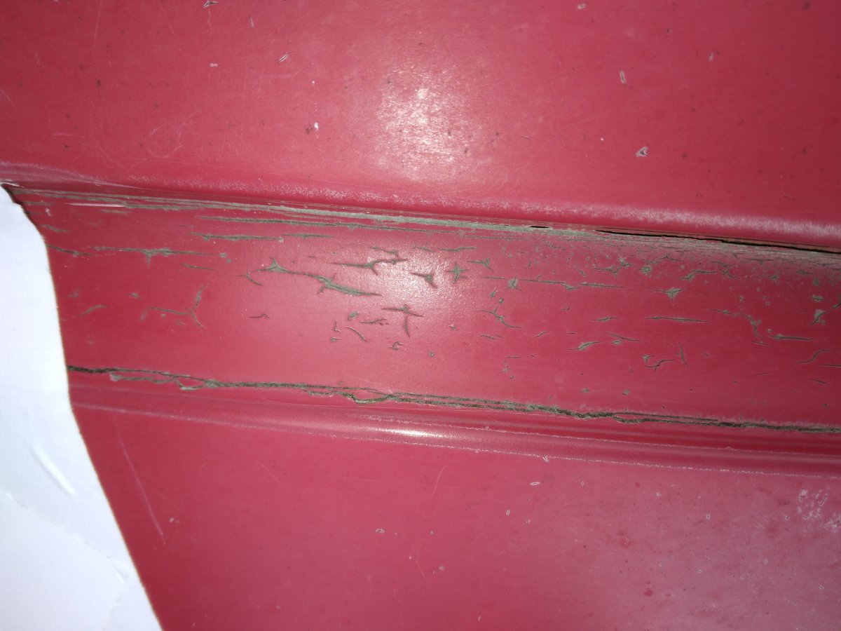

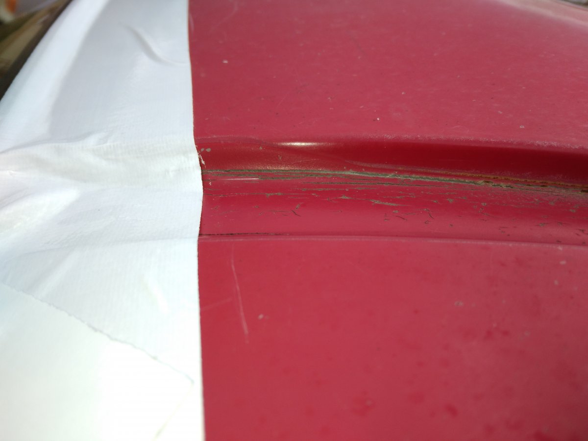

Honestly looking at the entire roof channel there is light surface rust where the paint is chipping off so ill sand it lightly and convert it also it looks like it's coming between the seam

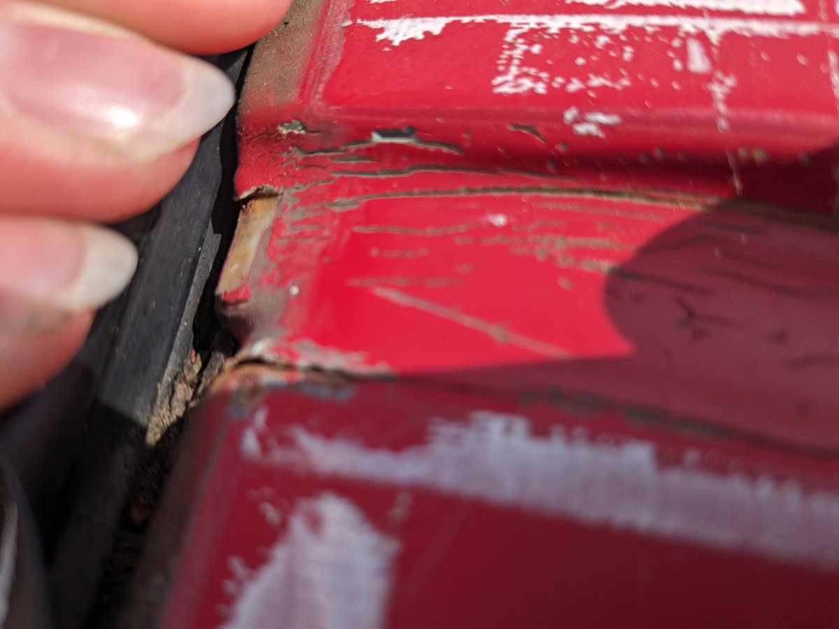

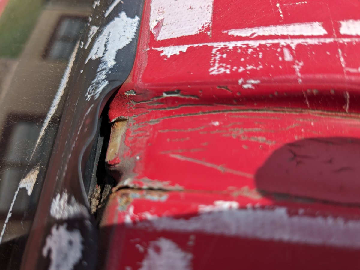

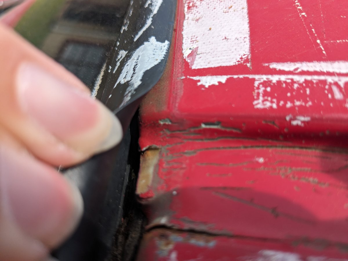

So finally I have had time to mess with the roof and clean things out since it's 80f out here now and this is what I found
Driver side
Passenger side
Looks like mostly surface rust which is good. The seam sealer looks to be cracking as well.
Was this just the windshield or both front and back?
Windshield driver and passenger side
The windshield seal looks very old, if the glass is that old and you might be replacing it soon, I'd cut all of the seal away that blocks your access. I'd rework that window channel to kill and treat all of the rust, and then do the glass(which comes with a new seal). If there is no rust right along the glass(thus under it), then it won't need any treatment there while the glass is being changed.
I believe the windshield is original, also what would be the best course of action to fix this?
I had to replace a windshield in my 99 Explorer less than two years ago, my insurance paid for it. The guy that did it said that they still cost a little over $200 to get it done at your site. That's a good price to get new glass, and the perimeter trim which looks better and keeps most debris from getting to the glass channel.
If you cut the trim off enough to access the channel, just clean it really well, and use a good rust converter after sanding the surface enough to remove most rust. A very very thin remaining layer of rust is fine for the converter products to react with and seal up. When it's done, then you just lightly sand it with a 150 grit etc, and final seal it with a quality paint etc.
Well my sealant of choice has arrived so I'm gonna clean the area thoroughly and use rust converter after I sand off all the rust I see and then use this sealant for the entire top of the windshield gasket and gutter to stop the leak until I can replace the windshield and get the vehicle painted
