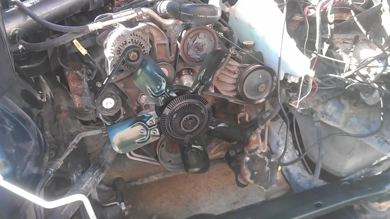

And right before my trip to Austin the water pump decides to fail. The whole bearing just gave way and pulley was just wobbling on the shaft. Tore up my belt pretty good.
I got the replacement water pump, but I can't seem to find the right tool to get the fan off the water pump. Its not a standard configuration.
Now the pump is fixed. Turns out one of those strap wrenches works pretty well for a make shift tool to hold the pulley.

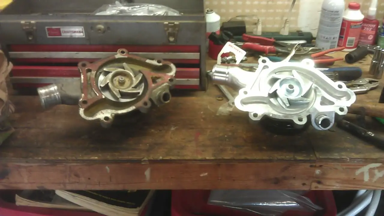

Old pump/New pump
Damage on old pump
In the process of putting everything back together I found the culprit behind the water pump failure: a bad tensioner. Apparently the belt had gotten loose and wasn't sitting properly on the pump pulley causing stress on the bearings and eventually destroying it. I wasn't too happy about spending another $70 on a new tensioner, but I guess it had to be done. :mad: At least I found it before it destroyed my new pump.

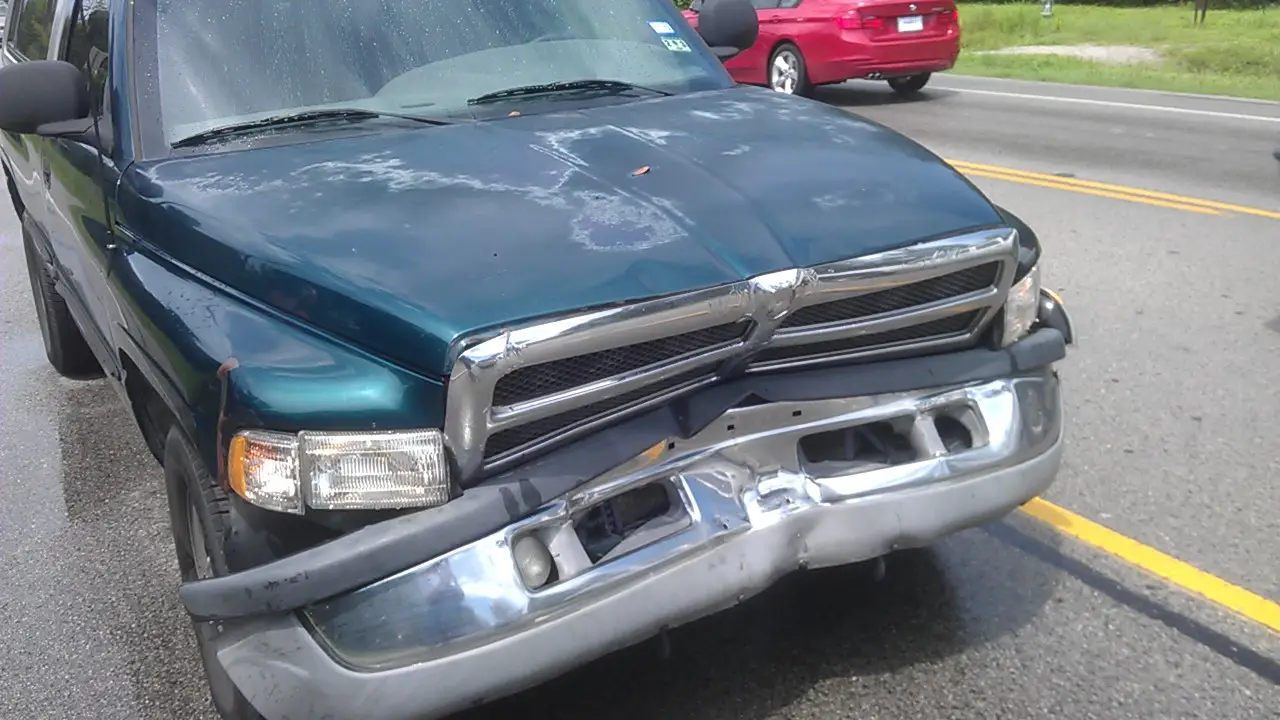

Over three months later and the Dodge is still going. Unfortunately a couple of weeks after I lost my job, I was driving the truck to get gas, and I rear ended a trail blazer. Just for the record, I was paying attention and the brakes were fully applied. Apparently when I was trying to stop, my brakes locked up on me. We had just had a light rain so the asphalt was pretty slick and I hydroplaned into the back of the chevy. Fortunately there were no injuries and the Dodge took the most of the damage.

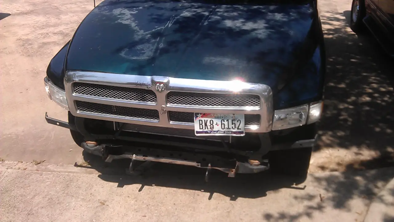

The reason that the damage is so bad is that I hit the trailer hitch sticking out of the blazers bumper. It essentially acted like a small ram (lol) took out the bumper, foglights, the radiator support, condensor, radiator, fan shroud and bent the fan blades. Took a bit of work, but thanks to Dodge not being miserly with their body construction: aka no welds, the whole front end was disassembled in 3 hours. I scrapped over a 100lbs of metal. But I still had to hunt down a new radiator support and bumper. It seems that supports in good condition are pretty rare and good bumpers are even rarer. I did find the support for $100 and just last week found (but haven't picked up) a good bumper for the same price. In the meantime I drive it in its partially assembled state with no front bumper and no a/c. I swear this truck looks horribly redneck, but I still find pride in driving it. Anyways on to the pics

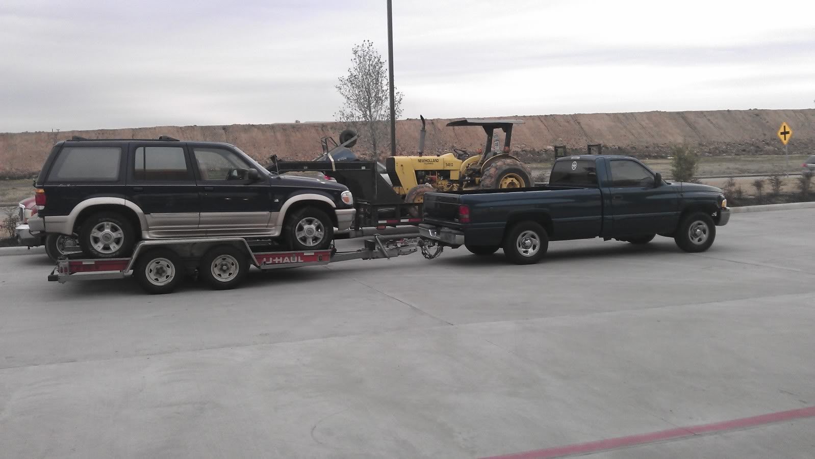

Its been a bit more than a few weeks, but what can you do? A recent trip to Austin (about 200 miles) lugging my parents Explorer certainly gave me a lot of appreciation for this truck. I believe I added up the weight and I wound up towing about 7000lbs. Now my brakes did not like that, (I desperately need abs and rear discs) and the RPMs were higher than I like (Towing with OD off), but nothing broke, busted or fell apart. Sliding through a left hand turn at an intersection aside, there were no issues (Raining all day).
