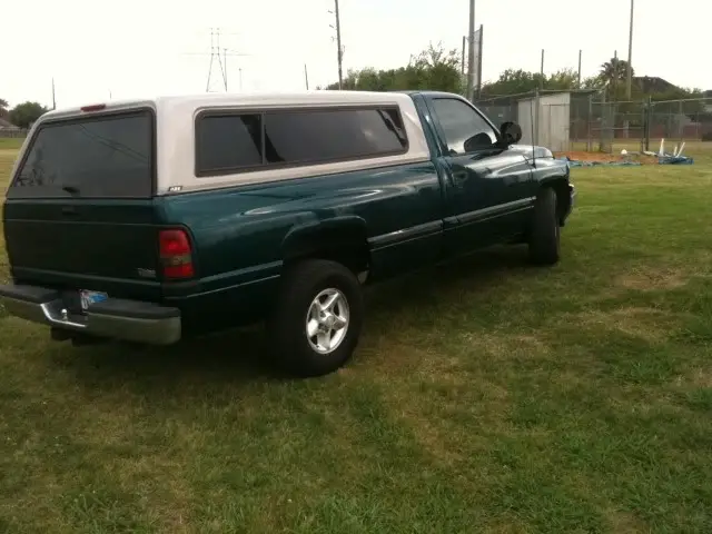

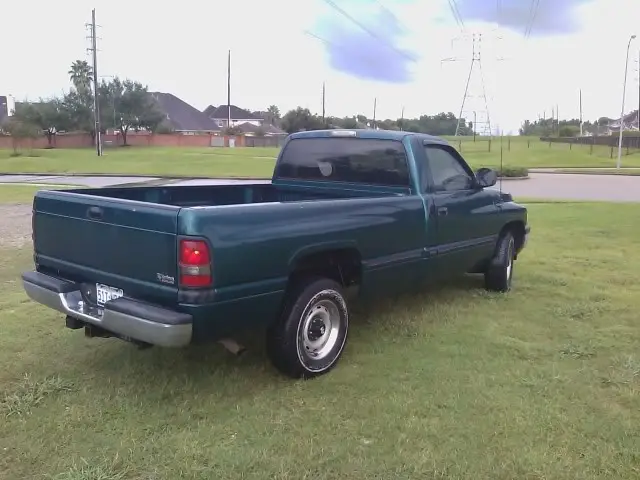

When I brought it home:
Now:

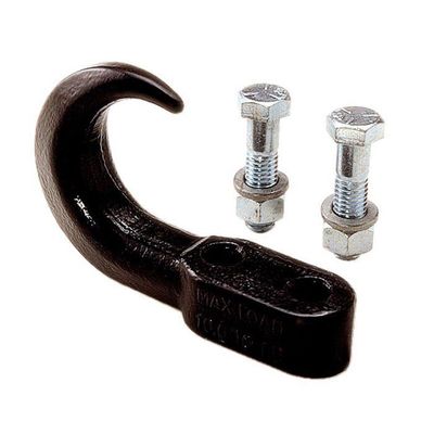

Two 10k lb. Reese Tow Hooks

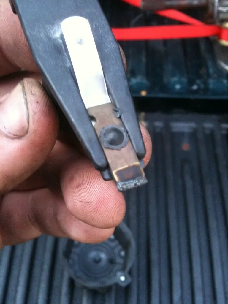

Did some maintenance on Thunder today. I decided to go ahead and replace the cap and rotor about a month ago and just never got to it. Well, after I did, now I know why I should have.
I also reran the spark plug wires as there was a TSB from Chrysler about problems with the current setup.

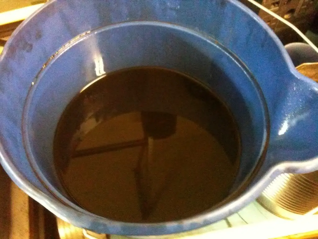

Next up I tackled my FIRST ever oil change. Yeah, I know. :rolleyes: A guy who has pulled trannys and converted a truck to 4x4 has never done an oil change till now. Anyways, I picked up an official MOPAR oil filter and used Valvoline High Mileage 10w-30 oil. It went pretty fast and there were no problems. I almost didn't need to put it on the ramps.
Here is the oil after, maybe, 2000 miles:
Not pretty, but the guy before didn't take really good care of the truck and probably didn't change the oil as often as he should have. This is only the second oil change since I have owned it. I hope the first one flushed most of the gunk out.
Yep, that rotor button is a tad worn!!

I would replace the spark plug wires if they're still the original or at least run an Ohm's/per ft. test on them to see if they're within specs.
So far the truck is running like a swiss clock right now, but I do want to get those wires replaced, its just a matter of having the money to do it. I also need to get new tires sometime this year, the ones I am running have about 5-10k left on them and are getting a little worn. I also want to change out the gear oil as well.

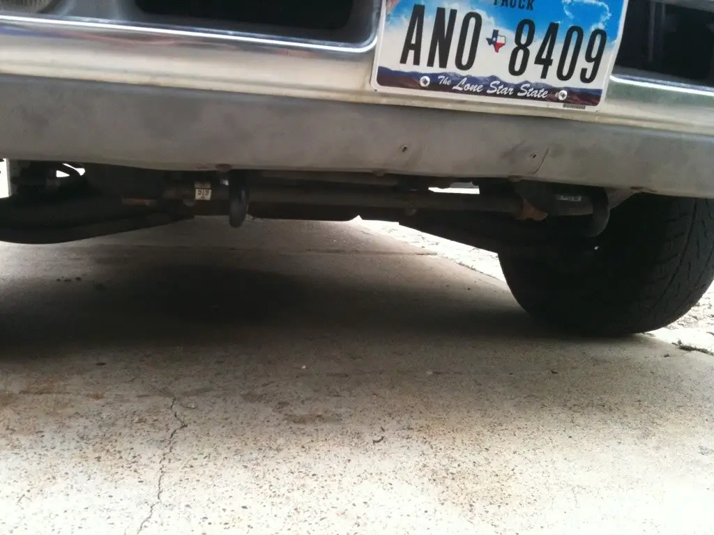

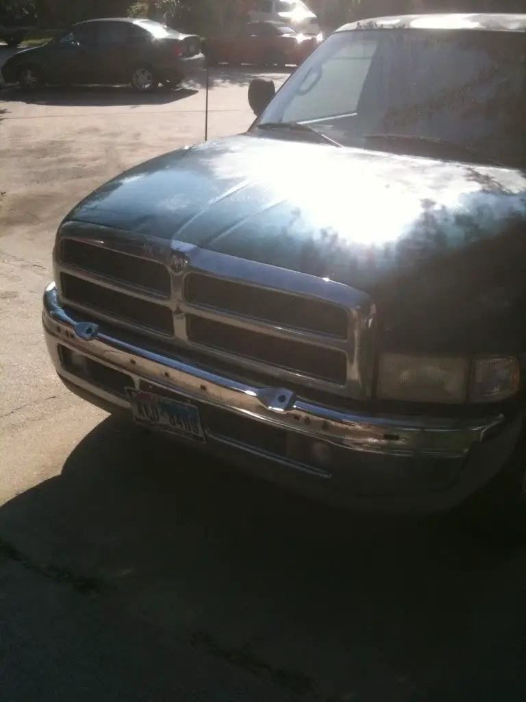

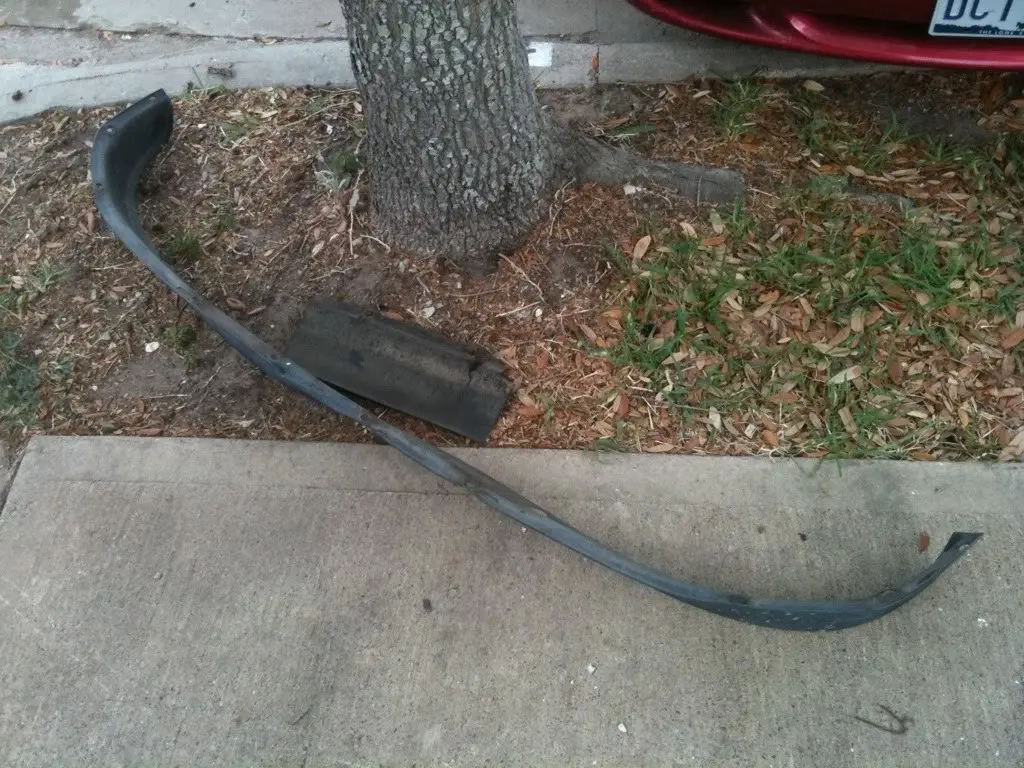

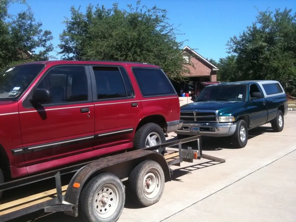

Yesterday, I used Thunder to push Red up on Mike's trailer. Unfortunately, Red wasn't about to go without a fight and kicked off the front of the trailer rail while I was still pushing it and slammed the trailer hitch into my front grill.
You can see some of the damage here:
Close-ups taken today
Some of this was preventable if I had another tire hanging around, but I didn't and this was the only way Red was going anywhere. So I said my "Oh $hit" and moved on.
I pulled out the support for the grill so it wasn't bent in and replaced the emblem with fresh epoxy, so all in all, its not bad, but Thunder will go around town looking like its got a broken nose for a while yet.

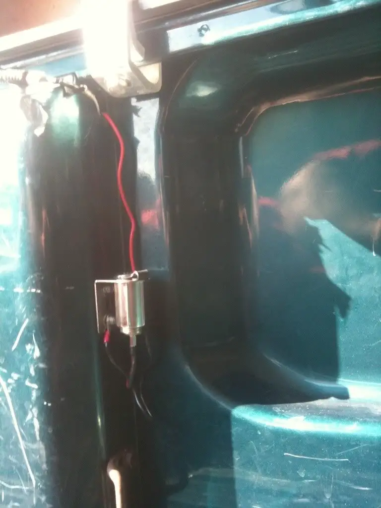

To make up for such a lousy day, I decided to spruce the Ram up with a truck bed 12v power outlet. The lead off the battery is about 20ft of 16 ga. wire, with a 10 amp fuse behind the driver's side tail light. All the connections are made with spade connectors, so if the camper comes off, I can remove the outlet and just leave the holder.

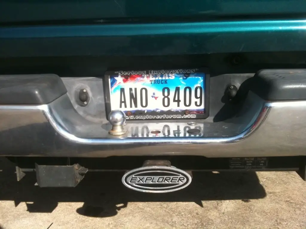

Last, but absolutely not least, I added a little EF bling to Thunder along with my 2" "Explorer" receiver cap:
Can Dark Thunder now be enlisted into the Ranks of the Explorer Forum? :D
