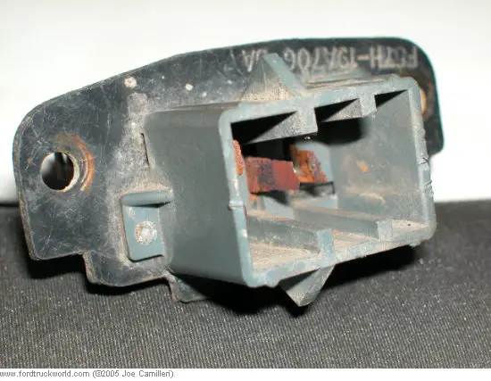

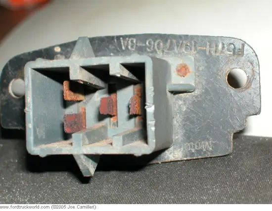

Go back to the dealership and purchase the pig-tail also. The resistor pack connector is exposed to the elements. Moisture gets in there and corrodes the terminals. The corrosion causes a hot-spot, and can melt the connector and burn the insulation off the wires.
The replacement just splices in, and the resistor pack only has two screws holding it into the blower housing.
It's easier to remove the resistors if you remove the screw holding the cruise control servo and lay it out of the way. Cut the wires back to where you have a good connection, then splice, solder, and shrink-tube the connections to keep them weather-tight. (I had to cut back 9" of wire to get to good copper thanks to the corrosion that had oxidized the copper up inside the insulation).
Then, before you reinstall everything, I sealed-up the outside of the plug with some copious amounts of silicone, and applied a liberal coating of dielectric grease to the face of the connector and the pins on the resistor pack. It should out-last the vehicle now. :)

Wait. A little sleuthing and I found the pics. They're all on this album page, 6 pics #5 through 10:

When you unplug the connector to the resistor/transistor module, you can use a flashlight to look in the connector to see if it looks bad, and if you're ambitious there is probably a plastic lock-insert that if pulled out, will release the contacts so you can examine them, and the ends of the wires where they connect, more closely.
Back when my resistor module went out, the wires and connectors didn't have any trace of a problem and are (AFAIK, it still works...) still fine several years later. For that reason I would assume the transistor module is bad and replace that, only looking at the wiring (more than a casual glance, as you should see if there is anything molten or charred like in the pictures) if it continues to be an issue.
Note I've used both the words resistor and transistor. As Koda mentioned, these are two different modules depending on whether you have EATC and need the transistor version or manual climate control with the resistor version. gijoecam had, and pictured (based on the F57H19A706BA part # stamped on it) the manual climate control, resistor version.
Since gijoecam originally posted these pics for us, and they're only failing to load due to site changes at fordtruckworld.com, I'm taking the liberty of reposting them in case further changes cause them to be lost forever...
Yeah, if you modules electrical connections look like these... I'd say you'd have found your problem.
